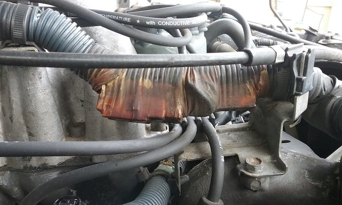

How would that effect the tachometer? That also looks a lot bigger than 2200 ohm.
Could this conglomeration be my mystery resister? It is near the distributor and does look somewhat like a small relay through the tape.

The guy said it was a resister taped to the wiring harness near the ignition coil, but my ignition coil is inside the distributor. Like I said, I undid the tape and plastic split tube and followed the wiring harness backwards to the T it makes and saw no sign of any kind of a resistor.

I have a tachometer flaking out. Done took it out of the dash and tightened up the screws like most of the YouTube videos say and it still does it, just not as bad. A person said in the comments of one of the videos that there is a resister taped to a blue wire in the wiring harness near the ignition coil. My coil is in the distributor, but I do have a blue wire in the harness connection to the distributor and I undid the tape and plastic split tube and followed the wire back for a ways and didn't find any resister. Does anyone know where this resister thing is at?
