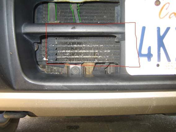

QuismO Posted July 22, 2006 Author Share Posted July 22, 2006 I was wondering, is this the stock tranny fluid cooler (outlined in red)? it's sitting in front of the radiator with two hoses (traced in green). Pardon my paintbrush skills hehe. if so, i'm assuming that i can just swap in a bigger cooler with hoses that are a tad longer to compensate for the height. wrong? Link to comment Share on other sites More sharing options...
FUELER Posted July 23, 2006 Share Posted July 23, 2006 yeah thats a tranny cooler you lucky SOB my 99 qx4 does not have one. Link to comment Share on other sites More sharing options...
97vapathy Posted July 23, 2006 Share Posted July 23, 2006 my xe has that one but it wasnt working very well so i got a bigger one Link to comment Share on other sites More sharing options...

mattd123 Posted July 25, 2006 Share Posted July 25, 2006 Uhhhh I think that is the oil cooler. i dont think pathys come with a tranny cooler or do the come with both? Link to comment Share on other sites More sharing options...
vengeful Posted July 25, 2006 Share Posted July 25, 2006 Up to `97 (not including the LE) had a trans cooler stock. The later models and LEs had them integrated with the radiator. Link to comment Share on other sites More sharing options...

vengeful Posted July 25, 2006 Share Posted July 25, 2006 Yes, but NOT the kind you think it does. That cylinder is an oil sump. UP TO and including the 1997 model year, other than the 1997 LE had external transmission coolers. AFTER 1997, the transmission was cooled by a separate core in the radiator. ALL vehicles have some sort of transmission cooling device, otherwise automakers would be having millions upon millions of transmission warranty claims ever 500 miles. Without any sort of cooling, a transmission will reach temperatures over 300*F, at which point, you're lucky to get 10 miles out of it. It is RECOMMENDED that you install an AUXILLIARY EXTERNAL cooler to Augment the existing internal cooler for a GREATER cooling capability. Link to comment Share on other sites More sharing options...

QuismO Posted July 27, 2006 Author Share Posted July 27, 2006 yea i'm going to replace that little dinky thing...it's banged up from all the bugs/pebbles/debris and what not...maybe i'll change the radiator while i'm at it. Link to comment Share on other sites More sharing options...
