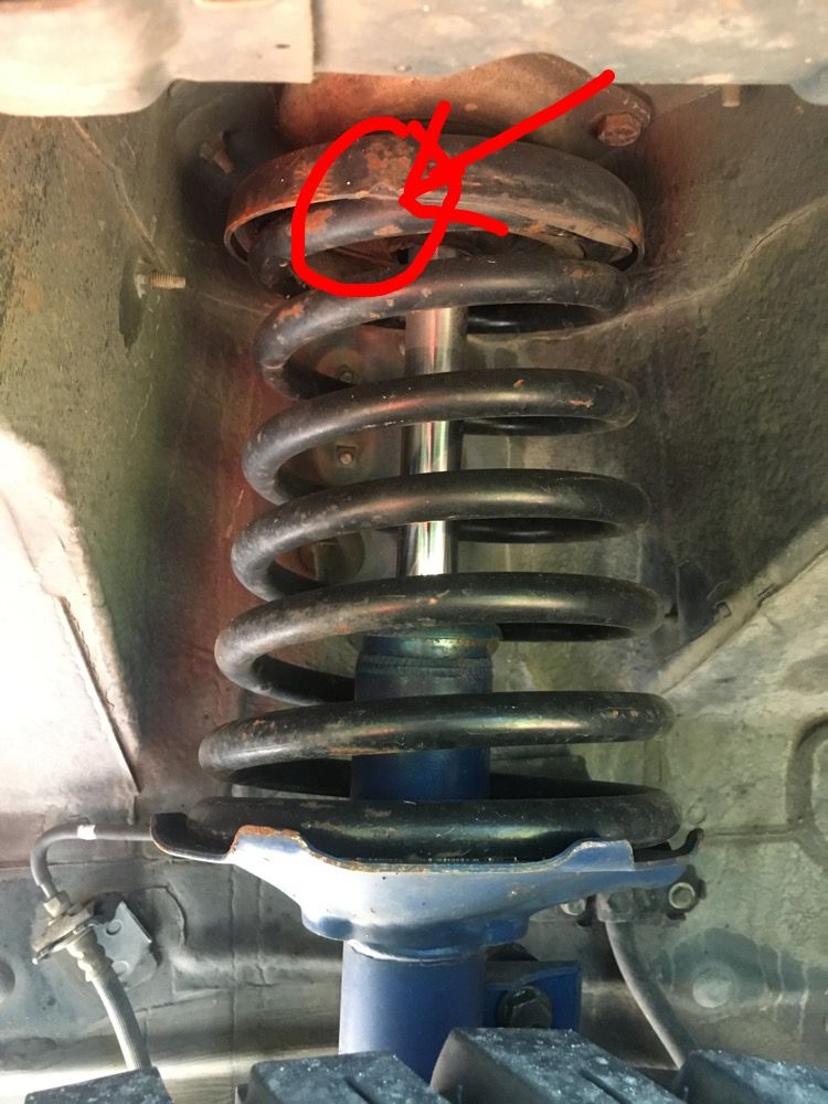

97Pathfinderman Posted June 13, 2016 Share Posted June 13, 2016 (edited) Do I have my strut tower aligned right because someone told me on the forums that the little notch should be facing the wheel and every other strut I have seen on other pathfinders have the notch facing the body. When turning my wheel it makes kind of a bowing noise and kind of creaks.Sent from my iPhone using Tapatalk Edited June 13, 2016 by 97Pathfinderman Link to comment Share on other sites More sharing options...
hawairish Posted June 14, 2016 Share Posted June 14, 2016 Faces inward towards engine, away from wheel. You may even see a "W" stamped on the opposite side...this side goes towards the wheel. Link to comment Share on other sites More sharing options...
97Pathfinderman Posted June 14, 2016 Author Share Posted June 14, 2016 Faces inward towards engine, away from wheel. You may even see a "W" stamped on the opposite side...this side goes towards the wheel. So the little v looking notch is supposed to face the engine? Link to comment Share on other sites More sharing options...
XPLORx4 Posted June 14, 2016 Share Posted June 14, 2016 The V notch on the top spring seat must be aligned with the V notch on the bottom spring seat (on the strut). See this pic: https://xplorx4.shutterfly.com/269 1 Link to comment Share on other sites More sharing options...
97Pathfinderman Posted June 14, 2016 Author Share Posted June 14, 2016 The V notch on the top spring seat must be aligned with the V notch on the bottom spring seat (on the strut). See this pic: https://xplorx4.shutterfly.com/269 So do I have mine backwards? Because I think my struts are a little different than yours. All mine has is the small engraved v looking notch on the top perch. Link to comment Share on other sites More sharing options...
XPLORx4 Posted June 14, 2016 Share Posted June 14, 2016 Yes yours are backwards. If your strut doesn't have a V notch on the back side of the spring pan, then line up the V notch on the top mount with the back side of the strut. Link to comment Share on other sites More sharing options...
97Pathfinderman Posted June 14, 2016 Author Share Posted June 14, 2016 Yes yours are backwards. If your strut doesn't have a V notch on the back side of the spring pan, then line up the V notch on the top mount with the back side of the strut. Ok thanks a lot I will correct my mistake this weekend!! Link to comment Share on other sites More sharing options...
97Pathfinderman Posted June 21, 2016 Author Share Posted June 21, 2016 t Finally got my strut towers rotated, made a huge difference! Thanks to everyone to helped me out on this! Link to comment Share on other sites More sharing options...
Enjoi408 Posted June 21, 2016 Share Posted June 21, 2016 Were you able to rotate the strut tower hat without unbolting the assembly??? Link to comment Share on other sites More sharing options...
97Pathfinderman Posted June 21, 2016 Author Share Posted June 21, 2016 Were you able to rotate the strut tower hat without unbolting the assembly??? No it had to come out. The springs are just too powerful. Its not that bad of a job though just take them out and use spring compressors to compress the spring and then rotate the spring. Took me about 3 hours total and i'm a slow worker. Link to comment Share on other sites More sharing options...
