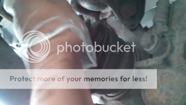

patqx4 Posted July 5, 2015 Share Posted July 5, 2015 (edited) So today I was trying to find an annoying knocking from my front end as I drive over bumpy roads, and when I pull on my drive shafts they seem to move in and out at the hubs, and make a metallic clunk. Is this normal? Im thinking this might be the noise. I'm thinking about removing the drive shafts just to see, but maybe I'm not installing them right and someone knows what's the problem here. http://vid26.photobucket.com/albums/c135/TwoGunzUp/Mobile%20Uploads/VID_20150705_125353_zps5onleq32.mp4 Edited July 5, 2015 by patqx4 Link to comment Share on other sites More sharing options...
ferrariowner123 Posted July 5, 2015 Share Posted July 5, 2015 I can't watch the video right now, but if it's the half shafts your talking about, then yes it's normal to have a little play in and out of the hubs. What suspension components have you changed so far? -Kyle Link to comment Share on other sites More sharing options...

jyeager Posted July 6, 2015 Share Posted July 6, 2015 That's more end play than I would expect to see in the axles. Do both sides move that much? I'm fairly certain that mine barely move. Link to comment Share on other sites More sharing options...
patqx4 Posted July 6, 2015 Author Share Posted July 6, 2015 Yeah, both sides are like that, they're the OEM axles. I've had them both out to change the inner CV boots, pretty certain I replaced all the c clips and everything. Link to comment Share on other sites More sharing options...
ferrariowner123 Posted July 6, 2015 Share Posted July 6, 2015 Bearings a blown if you are getting movement at 12 and 6, I had one of mine fail and make a awful sound, like a flat tire almost. Change both and the races, won't have to worry about them for another 150k. My bearings looked fine (even the blown one looked good to eye) but after the installation, it was smooth sailing. Order some new bearings and find somewhere to have new races pressed in. Grease um up, and should be good to go. Come to think of it I use to have a knock on bumpy roads and I haven't heard it since the bearing swap, all I hear is the tie rods and rear control arms (need to change those now). Hope that helps. It's an easy installation, just time consuming especially if you don't have a press. -Kyle Link to comment Share on other sites More sharing options...
ferrariowner123 Posted July 6, 2015 Share Posted July 6, 2015 That's more end play than I would expect to see in the axles. Do both sides move that much? I'm fairly certain that mine barely move. I have warn hubs and the play is around the same. I think it's a little less with stock hubs. But I believe the play is needed to allow for suspension travel. Don't quote me on that though. -Kyle Link to comment Share on other sites More sharing options...

Rebelord Posted July 6, 2015 Share Posted July 6, 2015 Thats way to much play for the cv shafts. In the FSM it tells you how to shim them for proper end play. Link to comment Share on other sites More sharing options...
ferrariowner123 Posted July 7, 2015 Share Posted July 7, 2015 Hmmm, weird. Looks like you're right. Interesting, I wonder mine had the same end play as him. Pat, was it only in 4wd you got this noise? Now I'm questioning myself. I think the best thing to eliminate if it's the shafts, is pull them out and drive down a bumpy road again. Still puzzled on that end play thing. -Kyle Link to comment Share on other sites More sharing options...
