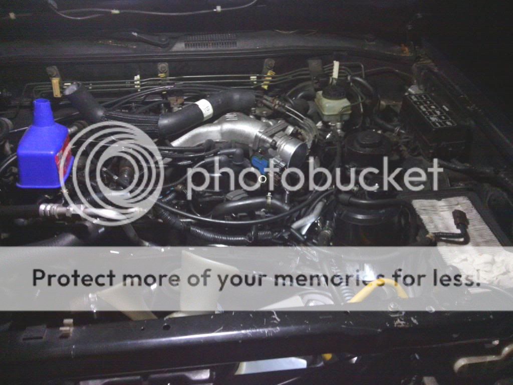

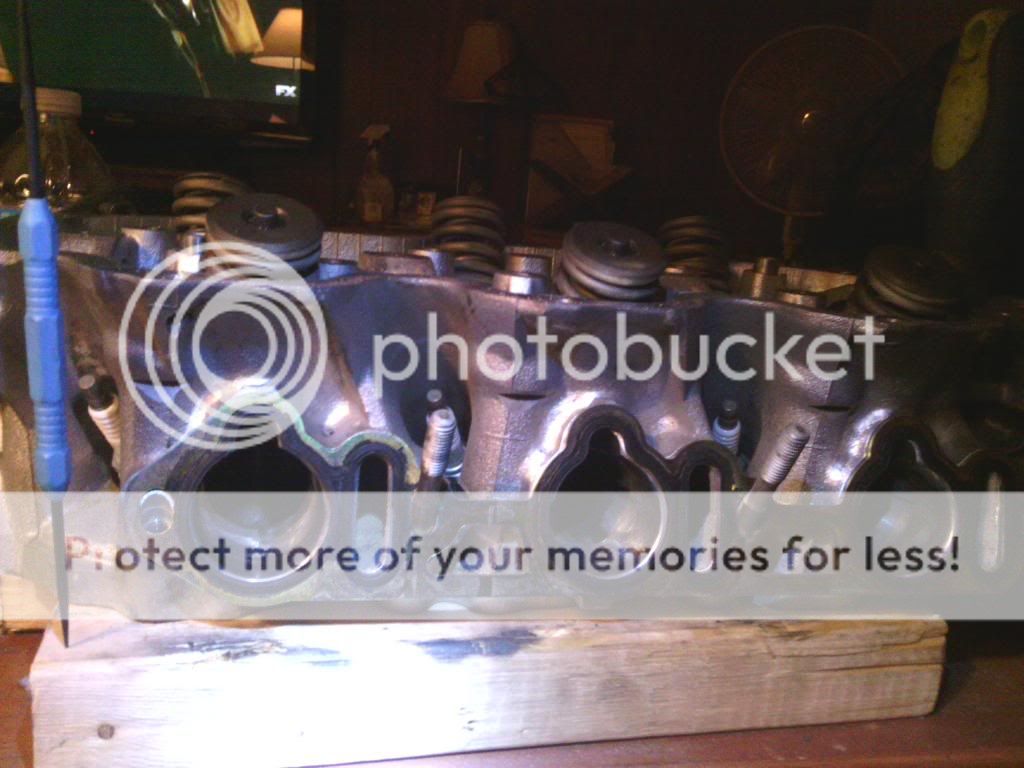

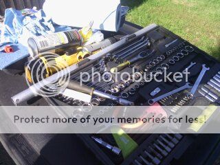

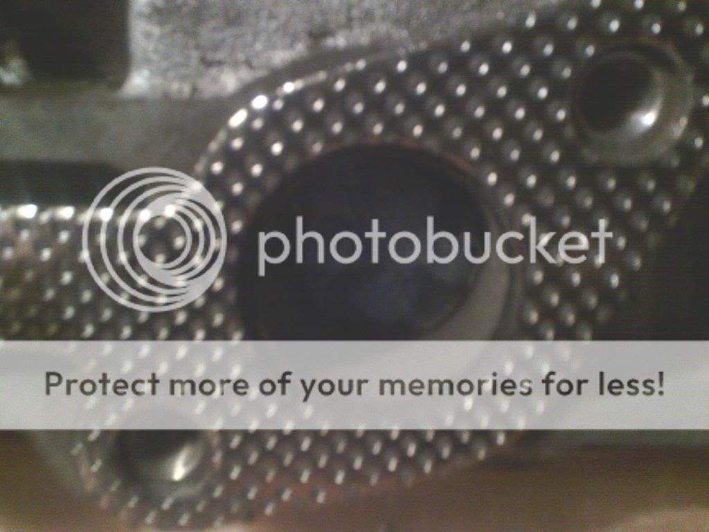

fixinto Posted December 27, 2013 Author Share Posted December 27, 2013 hmm looks like Nissan left a fair bit of meat on the bone from factory on their heads Well a little effort and a lot of time and elbow grease will fix that up a bit my happy tools FTW omw back up Link to comment Share on other sites More sharing options...

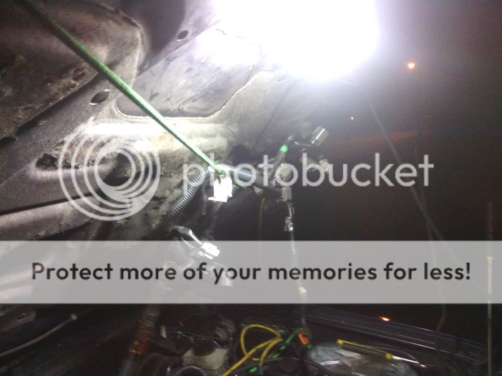

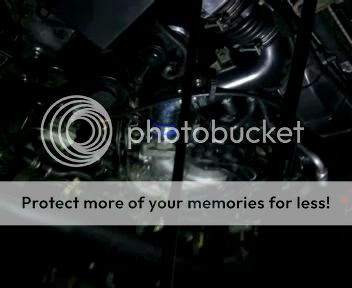

fixinto Posted December 27, 2013 Author Share Posted December 27, 2013 28 degrees F outside, and night time, so go go gadget hand warmer My nifty wire harness holder not the red electrical tape on the knock sensor connector, wire was a little floppy so taped it up figure may as well help it out since i replaced the knock sensor that was bad since i bought the truck lol Almost there bout 3am, Link to comment Share on other sites More sharing options...

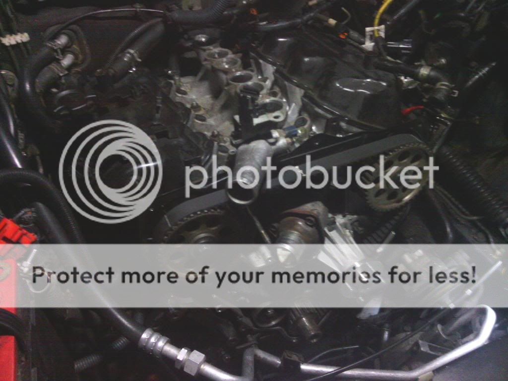

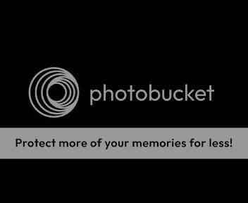

fixinto Posted December 27, 2013 Author Share Posted December 27, 2013 (edited) ok, first start, and under the hood action, the FMS said to soak the lifters in oil on their sides, well i soaked them all for 5 or 6 weeks considering that is how long it took me to get the $ together because wouldnt u know it? right when i started undertaking the project i went from 58 hours a week at work to 0 to 30 hours, i was barely hanging on by my fingernails. "thank goodness for ebay" anyways, other resources said to pump up the lifters by hand while submerged in oil so i did an experiment to see if it really made a difference, i pumped up the driver side ones and not the passenger side ones, "keep in mind they were all soaked for 5 to 6 weeks" not sure if u can tell on the video but they all ticked happily for about 3 to 5 minutes then quieted down and i havent heard a peep out of them since CLICK IMAGES TO SEE THE VID and the whine i believe is my balancer, when i was tightening up the fan and water pump pulley bolts i noticed that after the nut got tight i turned it and the rear two pulleys turned and the front one remained stationary, i have since ordered a new one. Edited December 27, 2013 by fixinto Link to comment Share on other sites More sharing options...

fixinto Posted December 28, 2013 Author Share Posted December 28, 2013 (edited) i forgot a pic, and sorry it took me so long to sort the pics and get em posted for those of you that were wanting to see them. anyways, here is the pic of the shiney happy head and freshly polished cam back on the block and i included a link to a youtube vid i made, not the best quality, but maybe it will give some insight on the updated version of adjusting your TPS. Edited December 28, 2013 by fixinto Link to comment Share on other sites More sharing options...

k9sar Posted December 29, 2013 Share Posted December 29, 2013 I would have fixed those cams and put on new seals. There is a product that is a thin sleeve that fits over the cam ends and effectively removes those grooves left by the cam seals. Did mine when I had it apart. no leaks at all. Link to comment Share on other sites More sharing options...
fixinto Posted December 31, 2013 Author Share Posted December 31, 2013 Must be nice to have her going again. Very nice indeed, Running better than ever, no ticks "ever" the one tick i had before i undertook this was on and off, and i believe it was do to a mostly clogged oil passage i found in the driver side lifter guide plate while i was cleaning everything up. the 18 dollar knock sensor is still workin like a champ. No Leaks and now it dont peter out around 3 and 1/2 k. It pulls hard on up to about 4 and 1/2 probably better than that. i just usually shift their when im in a big hurry, and thats not often at all. soooo i havent really stood on it or anything is what im tryin to say. waiting on a warm day to replace my balancer that i got in the day before Christmas because im not in any hurry to take anything off of it as u can possibly imagine lol. but the short of it is yes it feels great. and thank you. Pat Link to comment Share on other sites More sharing options...
fixinto Posted December 31, 2013 Author Share Posted December 31, 2013 Good job, and thanks for taking the time to post the picts and explain them. I'm sure this will help a lot of people down the line... B Thank you, in the future if i can find someone to give me a hand i will try to get actual videos and more detailed descriptions of the work im doing. As well as detailed pics but, for that build, i was working mostly at night do to working 2nd shift and it was a large undertaking for me so i just grabbed a shot when i was thinking about it and not cussing something that was stuck or too hard to reach lol. but ya it was a lot of fun minus the cold and "having" to get it back together asap. Pat Link to comment Share on other sites More sharing options...
fixinto Posted December 31, 2013 Author Share Posted December 31, 2013 I would have fixed those cams and put on new seals. There is a product that is a thin sleeve that fits over the cam ends and effectively removes those grooves left by the cam seals. Did mine when I had it apart. no leaks at all. I have no leaks, "as far as i know" I'm constantly checking the oil and radiator level to make sure everything is good to go, and ive gone over the bolts on the front of the motor and exhaust manifolds as well as keeping a close eye on my seals around the head and valve cover gaskets. It has been around 2500 miles and so far so good. but if i ever get that far back into it, i will probably purchase the euro cams so the seal grooves wont be an issue anymore. or better yet do an LQ9 swap. hehe. need another daily before i even think about something like that tho. Pat Link to comment Share on other sites More sharing options...
