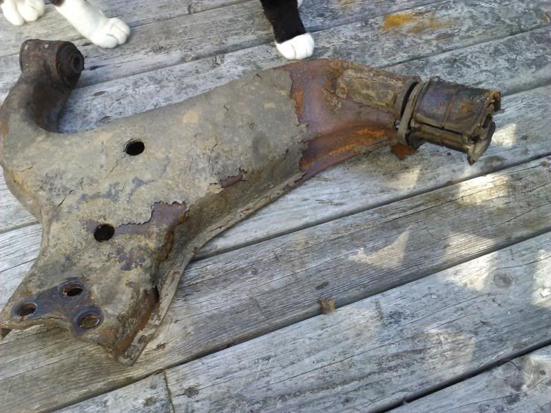

patqx4 Posted August 15, 2013 Share Posted August 15, 2013 ...of members who've crashed their pathys A-Arm is toast: And somehow I ruptured a brake line in the BACK! Can anyone help me with the part name and number for the steel brake line that broke? It's the line that goes into the rubber line to the axle. I have a new control arm coming tomorrow, and a new fender on Monday. I think I can save the headlight. sigh. Link to comment Share on other sites More sharing options...

Leo94 Posted August 15, 2013 Share Posted August 15, 2013 Can anyone help me with the part name and number for the steel brake line that broke? It's the line that goes into the rubber line to the axle. I have a new control arm coming tomorrow, and a new fender on Monday. I think I can save the headlight. sigh. That fender looked pretty salvageable . Link to comment Share on other sites More sharing options...
Karmann Posted August 16, 2013 Share Posted August 16, 2013 How'd that happen? Link to comment Share on other sites More sharing options...
Inyourface1650 Posted August 16, 2013 Share Posted August 16, 2013 The A-arm looks toast just from the rust... 2 Link to comment Share on other sites More sharing options...
Karmann Posted August 16, 2013 Share Posted August 16, 2013 The A-arm looks toast just from the rust... I blame the cat..... 2 Link to comment Share on other sites More sharing options...
patqx4 Posted August 16, 2013 Author Share Posted August 16, 2013 That fender looked pretty salvageable . No way... it's crumpled all to hell. Plus I could see afterwards that under the flare was completely rotted. How'd that happen? Drove it into a pole at low speed. brake line blew and foot went to the floor. Bummer. That is a list that I would like to keep my name off of. I felt the same way whenever I saw a post like this one. I never thought it would be me. The A-arm looks toast just from the rust... True that. I blame the cat..... Link to comment Share on other sites More sharing options...
