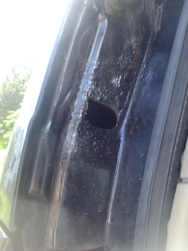

Quick update on this, I decided to cut and grind away as much rust as I could from the door jam with my angle grinder. This was the result:

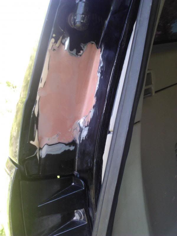

I sprayed on a couple coats of rust reformer and let it dry, then cut a filler patch and jb weld'd it on:
I'll be the first to admit that I don't know what I'm doing when it comes to body work, but hopefully with a little bondo and alot of patience, I can make it look half decent. Doesn't need to be beautiful, since it's hidden except when the door is open.
looks good to me...better job than any i've done...but then again that is a bigger hole than any I've had to contend with...is that the D pillar, or the rear door? That was much more cancerous than it looked...
Edited by Bluewulf73
Thanks Bluewulf, yes, it's the hatch door jam right above the drivers side tail light. I finished the "repair" this morning. and it looks better than I expected.
Bondo
Final result, primed and painted
I'd call this resolved, for now at least. It looks better than the rust hole, and the best part it was free since I already had all the supplies used.

Looks great! unles one looks very closely, it is difficult to see there is a repair at all... :clap:
