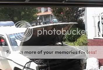

So here is me on a 5 gallon bucket after not driving my truck for 1.5 years...its throleys and no y pipe....under high revs flames hit the concrete...don't mind the dough nuts marks in the road, house struck by lightening or the burnout in the driveway lol...
http://vid193.photobucket.com/albums/z48/unccpathfinder/Pathfinders/testdrive.mp4
Sounds like poop but I won about $200 in showing folks it had a Nissan 3.0 l under the hood
Here's the first crank...my roommate told me fire so That's y there was the freak out...this was first crank with mpfi on my 87 after it sat... hence the couple celebratory hollars...straight pipe again no y pipe
http://vid193.photobucket.com/albums/z48/unccpathfinder/Pathfinders/alive2.mp4
