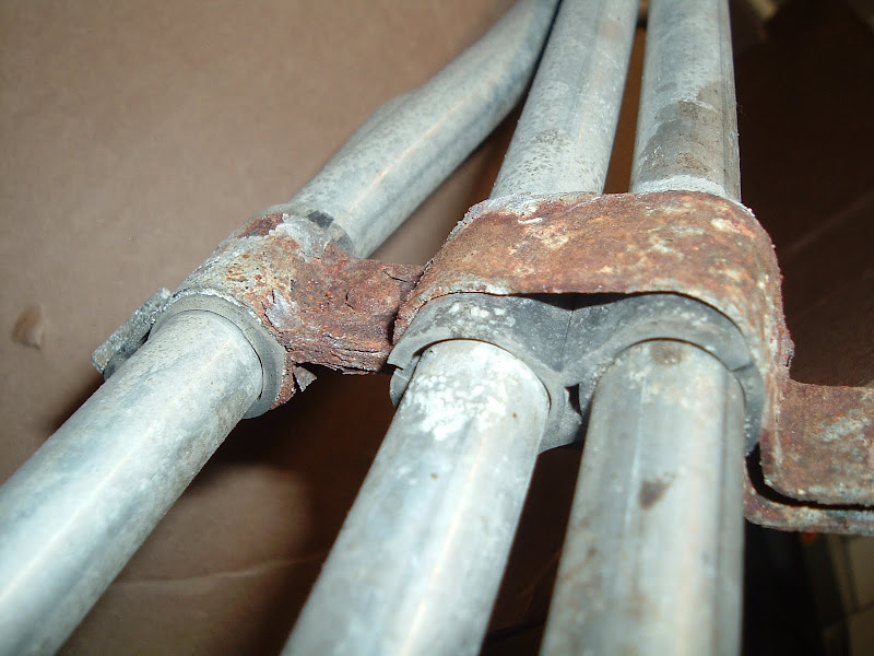

morpheus Posted July 6, 2010 Share Posted July 6, 2010 Hey Mike, can you post a pic of the foam insulation that needs to be removed? From what I remember, it's in theese areas: The spots that the plastic clamps hold the lines together are also a place that cause issues. Link to comment Share on other sites More sharing options...

jerry6 Posted July 6, 2010 Author Share Posted July 6, 2010 Thanks for the diagram , up on the lift it goes . So foam AND the plastic clamps have to go ? What to use in place of the clamps , plastic ties with rubber surrounds ? Link to comment Share on other sites More sharing options...
Tungsten Posted July 6, 2010 Share Posted July 6, 2010 zip ties Link to comment Share on other sites More sharing options...
morpheus Posted July 6, 2010 Share Posted July 6, 2010 Heres a pic of some Armada lines we replaced, they are similar It's a catch 22 if you should remove the brackets or not. The best way is to take the clamp apart, make sure all the dirt and grit that might "sandpaper" through the lines is cleaned out, and use some new foam, then seal it up with something. Link to comment Share on other sites More sharing options...
