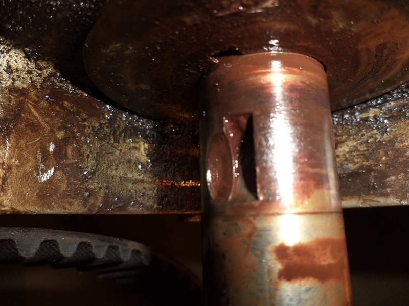

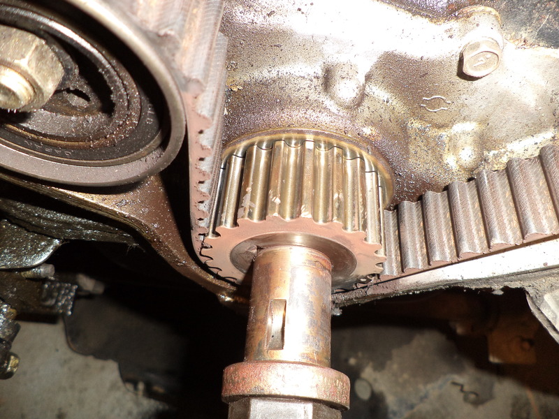

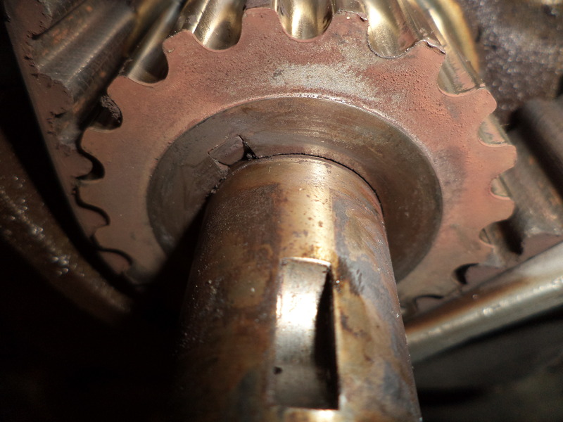

SkiMachine Posted May 28, 2013 Author Share Posted May 28, 2013 I think pictures will tell a thousand words on this one. This didn't look too hopeful... : When disassembling I noticed that the drive pulley could be turned a bit without the timing belt moving, so I knew something was up right away. This also explains why the issue was progressive in nature. As for cause? I'm not 100% sure, but the crankshaft bolt was really loose (ie: wrench NOT required for removal) so it could be impact as the gear wobbled back and forth. There is some marring on the timing gear (see first picture, I'll upload a close-up tomorrow). I'm not sure if something got jammed in there, or someone scratched it up with tools in the past (ie : the guy who didn't torque the crank bolt down properly). Either way it would have taken a serious hit to have caused that kind of damage to the crank. I'm at a complete loss for on-vehicle solutions to this one. Anything I can think of involves tearing down the engine, and a trip to a machine shop. At the end of the day, this is a 20 year old car, with 219,000km and a transmission that also needs rebuilt.. I'm going to have to think about my next step. Link to comment Share on other sites More sharing options...
Precise1 Posted May 28, 2013 Share Posted May 28, 2013 (edited) Damn, that isn't good, but does explain a lot... Redpath88 did an on vehicle repair to his crank snout which I believe consisted of cutting a new keyway at 180* and indexing the pully, so it can be done. Wrong, fill weld and regrind seems to be the only way and Red bought different motor. So much for my memory... B Some links http://www.nissanpathfinders.net/forum/topic/31036-broken-crank-keyway/?p=587580 http://www.nissanpathfinders.net/forum/topic/31078-crank-snout-woodruff-key-question/?p=588473 http://www.nissanpathfinders.net/forum/topic/21986-rolled-crankshaft-woodruff-key/?p=387532 Edited May 28, 2013 by Precise1 Link to comment Share on other sites More sharing options...

SkiMachine Posted June 28, 2013 Author Share Posted June 28, 2013 (edited) Finally got around to working on this some more. 6 day work weeks, hockey playoffs, and being bicycle distance to work, amongst other things kept me from getting back to this. We ended up welding the TG woodruff key in place. I changed the oil seals, belt, tensioner, put it all back together and now it's running smooth with plenty of power. Compression is now ~ 175 +/- 5 or so psi across all cylinders which is pretty much dead on spec. The old woodruff key was completely destroyed, there was maybe just 1mm or less metal left before the timing gear would have been free-wheeling... As for why this happened? I think whoever said (in one of the threads linked by Precise1) that the woodruff key is just for indexing and it's the crank bolt that's supposed to hold everything in place is correct. Whoever said the woodruff key is too short is also correct, IMO. With the woodruff key fully pressed in there was at least a 2mm gap between the top of it and the bottom of the TG index slot. Obviously centerfugal force would migrate the key fully up into the TG over time leaving even less contact with the crank shaft. The crank bolt not even being finger tight just sealed the deal. My best guess is the previous guy in there just used a rattle gun to tighten the bolt, didn't lock up the crank shaft while tightening (I made a crude tool to do this), or both. So now on to the autotragic.. The fluid looks black, or at least dark brown to me.. Edited June 28, 2013 by SkiMachine 1 Link to comment Share on other sites More sharing options...
