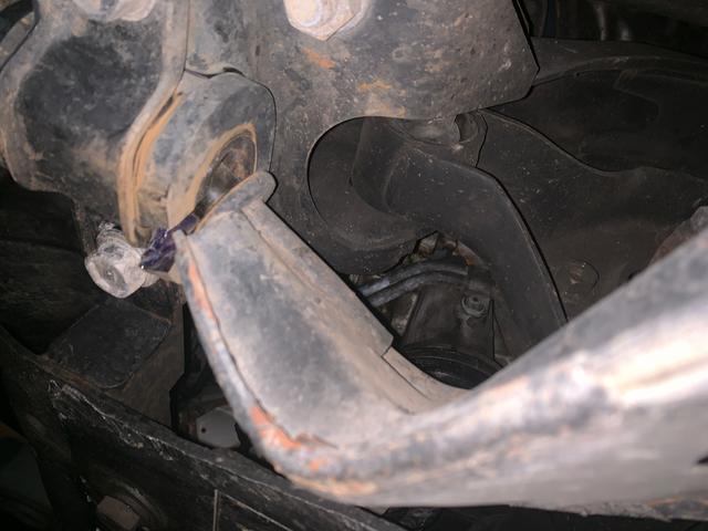

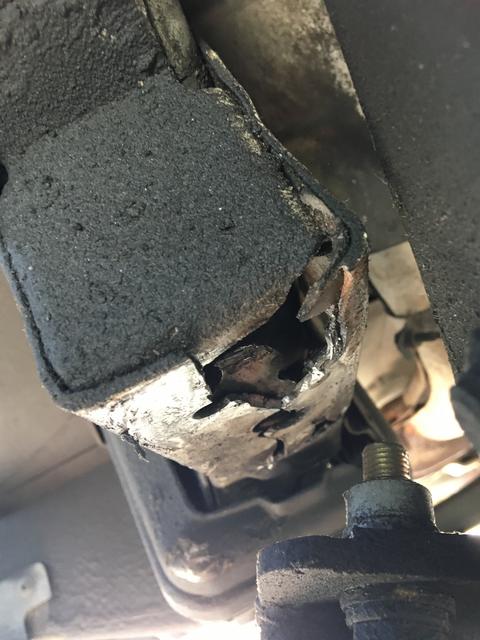

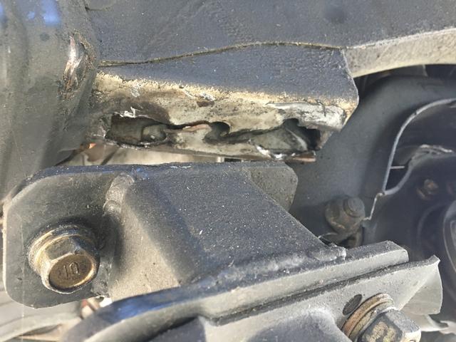

This is what is possible without a missing link on an SFD'd truck (not mine):

Thank you for the pictures that is exactly what I am afraid will happen I also have them welded at the top. I want to do something that connect the blocks together but the front drive shaft is in the way. I was think of doing a triangle form the block to the missing link

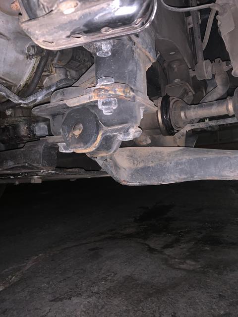

Those damage pics are from my buddy's truck, @Jax99.  His spacers are identical to mine...in fact, I had them made and I did that install several years ago, shortly after installing my own.  The difference is that I've had a missing link and skid plate the whole time.  He's since had the subframe replaced and the chassis repaired, with the blocks welded on in that spot and gusseted to the subframe, plus the truck now has my old missing link and skid plates.
But wait, there's more...he recently struck a curb on the same side he had subframe damage.  This is the difference of damage transfer when a missing link exists and the spacer is reinforced:

For yours, I think you need similar gusseting.  I'd say weld them to the top of the subframe if needed, but you may also need to consider a way to box in that 6"x2" tube.
