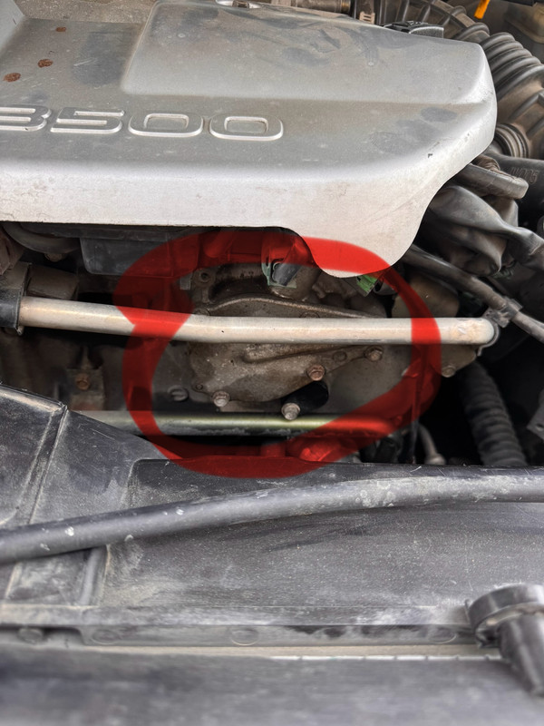

wesley910 Posted July 7 Author Share Posted July 7 (edited) I got a sethoscope today and seems to really be coming from this area- Im not sure whats behind here Edited July 7 by wesley910 Link to comment Share on other sites More sharing options...
