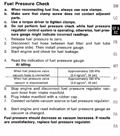

With hot soak, a couple things to check. Check for spark, sometimes the ignition module in the distributor will fail when hot. Check your fuel pressure, but also watch for pressure drop. Fuel pressure I think should be 30-40 psi range if I recall correctly. It should hold the pressure for a while after the engine is shut off. If it drops more than 10 psi in 5 min, it is possible you have a leaking injector that is flooding the cylinder making hot starts hard. You can try holding the throttle open while cranking and see if that helps. Have heard reports of injectors failing when hot also.

If I recall that should be over 43 at startup and 51 running warmed up at idle.

Was eating dinner and trying to recall a spec I haven't used in years. I deal with many different years, brands, and models at work so my memory is not the most trustworthy. According to the manual I have stored on my computer, the pressure regulator is supposed to keep it at 43 psi approximately. That is for the VG30E in the Pathfinder/pickup application.
