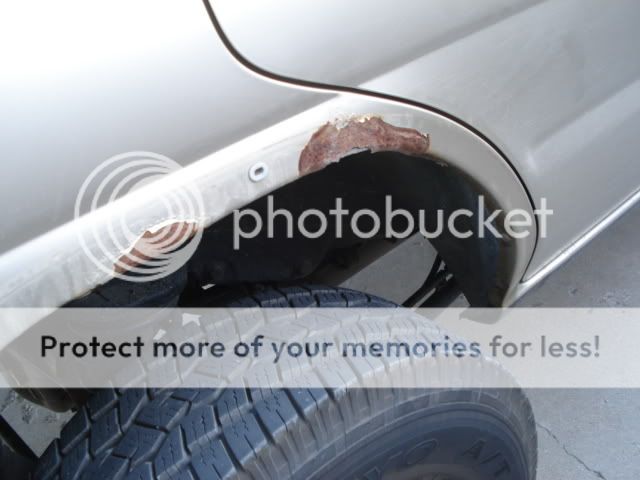

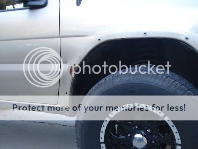

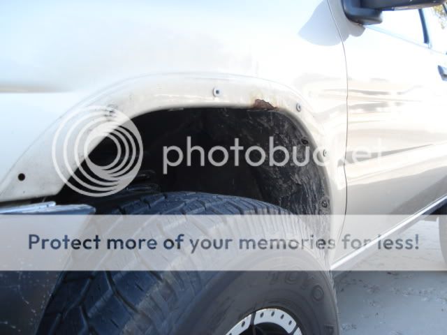

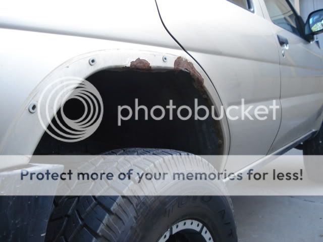

I have uploaded pics of the rust on my R50... quarter panel repair is a kick in the teeth.
I'm looking at about $600 for the right side alone :(
The rest may have to wait till spring...
Here are the links with the so-called 'target spots':
http://i452.photobucket.com/albums/qq242/t...50/DSC07143.jpg
http://i452.photobucket.com/albums/qq242/t...50/DSC07144.jpg
http://i452.photobucket.com/albums/qq242/t...50/DSC07142.jpg
http://i452.photobucket.com/albums/qq242/t...50/DSC07141.jpg
http://i452.photobucket.com/albums/qq242/t...50/DSC07140.jpg

Thats all you had? You're lucky.. check out these pics from my trip to the body shop...
