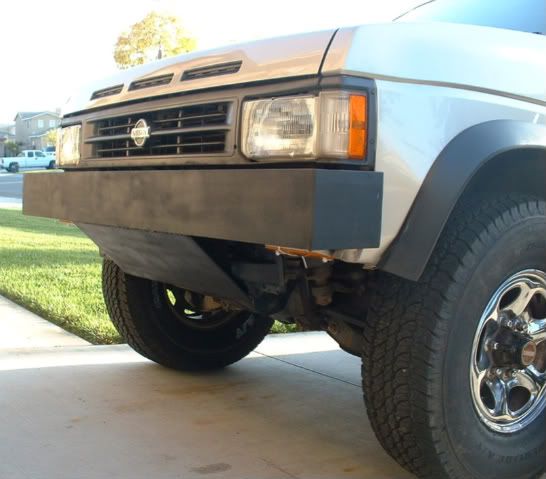

do what i did.... buy a smittybuilt for a yota (mid 80's) and "modify" it to make it uber strong... hehe
I'm starting to fimly belive that the w/d21 croud is best off buying 80's toyota 4runner/pickup parts and adapting them rather than waste time energy and money trying to find nissan specific parts!
well, lemme put it like this.... i paid $100 for the smittybuilt from transworldmoto (ben) on the forums.... i asked smittybuilt how much for a pathy...... $450 :blink:
yota front ends seem to be of similar dimentions, width wise and such, so with VERY LITTLE mods, i have a bulletproof bumper...
Doug, what welding did ya have to do for install, and can you get us some more pics. Would like to see how it looks aside from the one pic on the website.
I'll get some pics and post them ASAP. You have to butt weld 2 lower mounts on the lower parts of bumper after you fit it up on the Kennesaw. The steel is pretty thick; 3/16 I think so I stick welded it probably 12" of welding in all.

Of, I forgot you also have to weld the stock bumper mounts to the top of the KM bumper

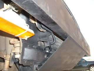

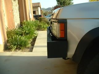

Okay .... here is an update ..;.. sorry, i'm at work so no pictures to post, but my new bumper is super strong and ugly. very square with strong angles. my skid plate is also about 3/16" steel at is welded from the bottom of my bumper to the frame rails.
i do have one consern. the body mounts are exposed and unprotected ... i know ... in factoy form, it was only covered by a thin piece of metal before and for looks only. but now i'm concerned that i may hit it. my new skid plate is only the width of the frame rails on each side of the pathfinder.
do you guys think i need to cover it up with some steel for protection?

if i am getting a visual of what you are talking about correct, no, you don't need a skid plate all the way across. some prefer it, but it is not crucial to your pathy's survival. if oyu plan on betaing it up THAT BAD. you may wanna think about SAS anyway....
did he leave room on the skid plate for you to remove the oil drain plug?
oh yeah, i forgot the part about..... your tires need to turn......
It should be fine, Mine ar prtty exposed on my 88, but haven't gotten near hitting the mounts ever.
the skid plate does not extent down that far. it is only to the frame rails. so about a foot in height from the bumper to the frame rails. i can still take the original protective plate off so it does not cover my drain plug. and i still have full turn of my wheels.
and your right i'm dont go offroad that hard. i just didn't want to damage my body mount and body alignment anymore that what i've already done. and i did that (body damage) with my old bumper. boy did i come close to damaging my AC radiator. ofcourse.... that could have also lead to my radiator damage too.
so i guess my original intent is accomplished.

how thick is the skid plate? looks kinda thin to me, well as long as it works, I guess. it'll be nice if they extended the upper part of the plate for that extra protection that you are looking for.

OP, could you get a shot of the mounting tabs that they used to mount the bumper? Thanks
