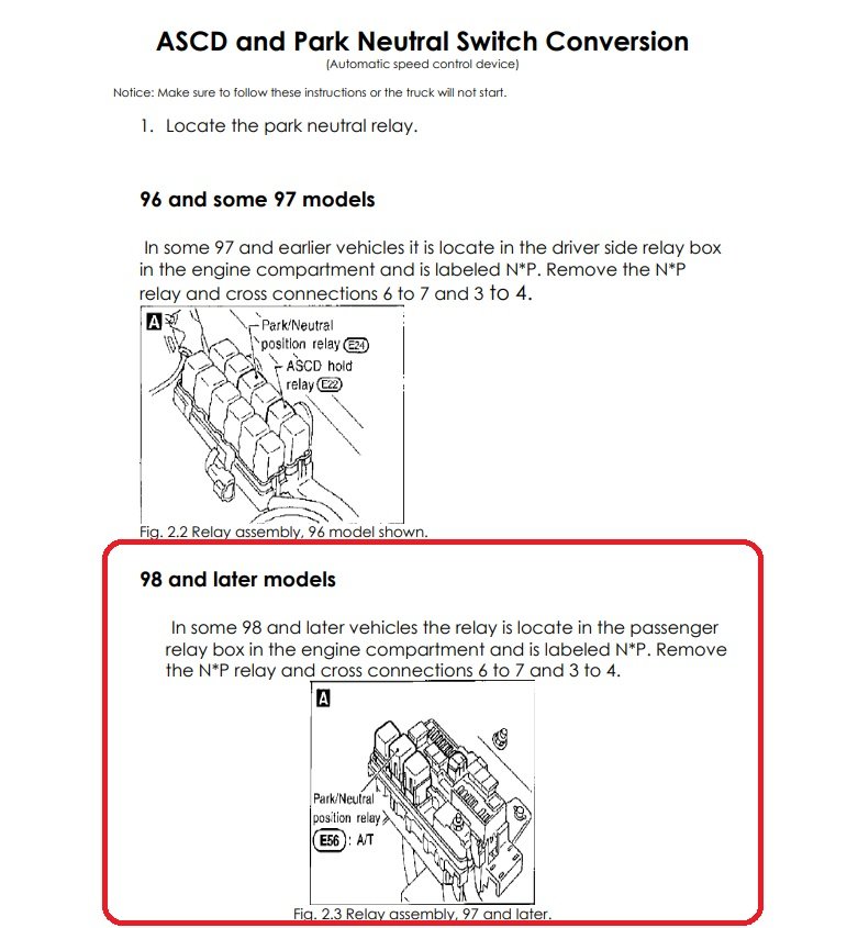

  1. Thats some good looking out there, thanks for doing that. Ill confirm my ASCD is the first part number, but I think you are correct. So that clutch safety would just be pulled from the donor vehicle and two wires ran to the PNSS relay spot right? Just put the two wires into the corresponding pin location? If that is the case, would pin 18 on the TCM be telling the gauge pack to turn on the cruise light when cruise is enabled? Do I need to worry about that or does the ASCD also do that with its pin 13? A rail shifter? Huh, yeah Im sure the electronics would go haywire if it was noticing a different input. Thanks again for your help.
  2. Hawairish Hey man, thanks so much for replying, I really appreciate it. Posting those schematics is a huge help. I looked for the FSM and where it once was, its gone now. I think Nissan made them take it down or something. I bought one on Ebay, but the guy is taking his sweet time to ship it. Sorry about the simple questions, but I want to be absolutely sure before I dive into this. When you write that I need to " replace the Park/Neutral Position Relay with the Clutch Switch, or wire it between the Brake Switch and the Hold Relay and bypass the PNPR". Are you explaining it like the manual is here on page 14 from the manual? Yes, as I was reading up on this I noticed in a few threads that the 3.5's had a power valve on them for the automatic equipped R50s. To correctly convert a 3.5 equipped R50, you have to replace the upper and lower intakes, amongst other items. Once Im done with this, Ill gladly create an addendum to this manual to help any other R50 owners that are looking to convert their autos.
