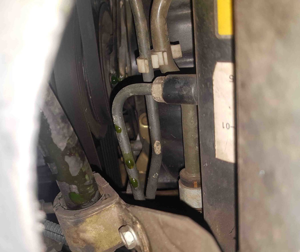

Ok Yeh great, I think you may be right, If I'm correct I think the water pump is directly above this. Yep it's the VG33E Thanks guys
Recently had the radiator replaced, today I noticed a coolant leak. I have one disorienting picture attached, can anyone diagnose where this might be coming from? This is taken from the underside, as you can see all the drive belts, this is dead central. Looks to be coming from above the metal piping. I can't see any leaks from above. This is a 2003 pathy Any help would be appreciated!
