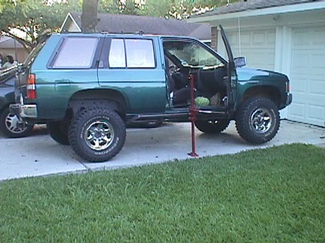

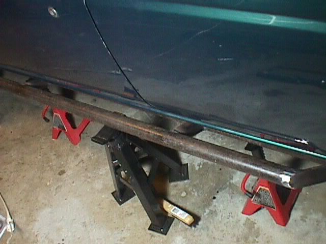

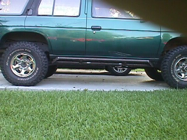

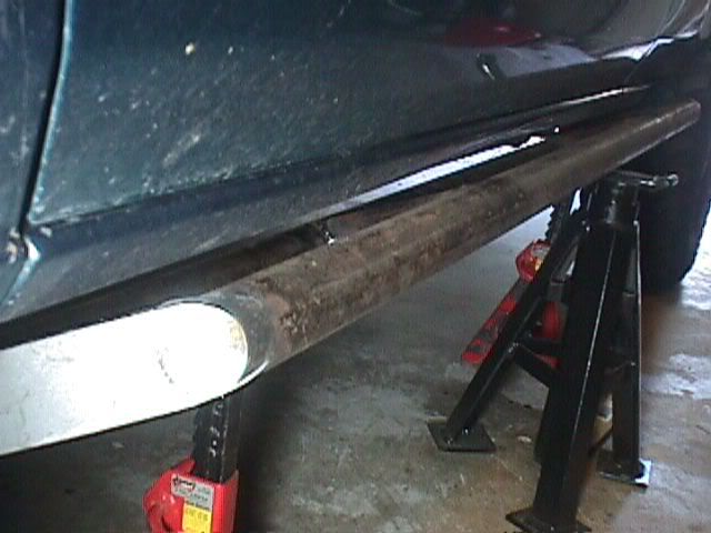

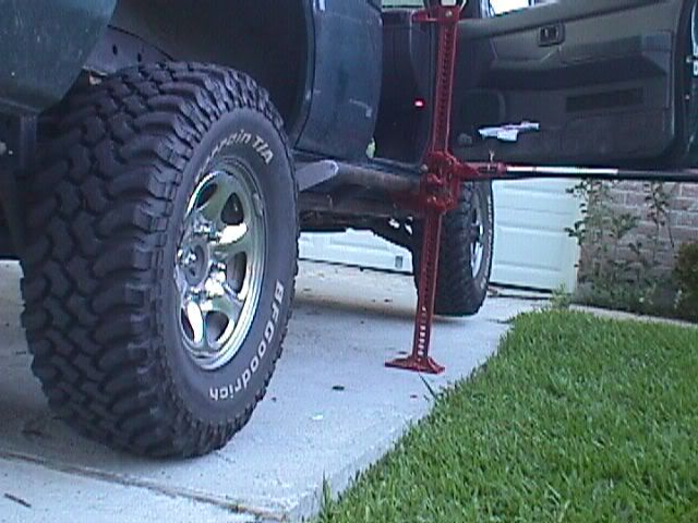

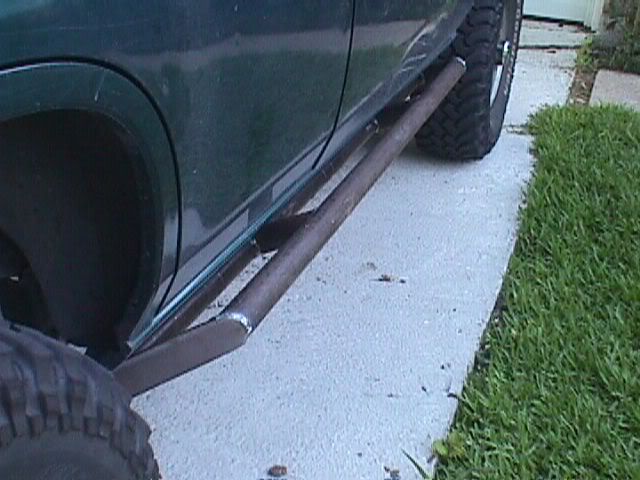

TrailChaser Posted May 12, 2006 Share Posted May 12, 2006 I built these at work in about 2 weeks of lunch breaks. They are 21' of 2" OD pipe. Here's a couple of pics from when I was figuring out the angle. I settled on 27degs. Here's the pics from today when I got home with'em finally on the truck. I had to block the sun with my hand. A little closer. In these pics I'm testing the sliders to see if they can handle the weight of the whole side of the truck. The front tire is off the ground and the rear tire is almost off. I was at an incline and didn't want to risk it moving back so I stopped at that height. Now I just need to sand off the oil crap that coats the pipe and then paint'em black. They're sooo close to the body that I'm considering painting the rocker panels black also. That might help mask the damage I've already gotten from Barnwell Mountian. You've probly seen those pics, but if not here they are. Drivers side... Passenger side... The scratch/dent on the door is rockrash that wouldn't be there if I would have had those sliders back then. Link to comment Share on other sites More sharing options...
DTE Posted May 12, 2006 Share Posted May 12, 2006 those look niiiiiiceeee, i wish i could weld so i could start building sumj stuff for my pathy...how did u mount them to the frame? welded, or just bolted up somehow? Link to comment Share on other sites More sharing options...
TrailChaser Posted May 12, 2006 Author Share Posted May 12, 2006 I welded'em on. Three mounts on each side with 1/4" plate 5"x4" welded to the frame to spread out the load when I get on a rock or have to jack it up. Main thing that kinda sucks is that they are a little below the frame rail at the mounting points. It's not too big of a deal tho. I really don't want a body lift, but that would definately solve that problem. Link to comment Share on other sites More sharing options...
