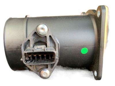

EricCR Posted September 1 Author Share Posted September 1 (edited) Ok, I narrowed the problem down. It only stalls when the engine is hot and only when coasting or idling (no throttle input). Under throttle the car behaves perfectly. If anyone has any ideas I'd really appreciate it. I don't want to simply throw parts and money at the problem. I'm getting no codes so I'm at a loss. I cleaned the MAF and added RedLine fuel cleaner, but the problem is getting worse. EDIT: Can someone with a 2003 throttle-by-wire Pathy confirm if the MAF is 22680-CA000? I believe mine has the wrong MAF, clearly told apart by one having the torx screws holding the sensor in place in a straight line and the other having them in diagonal. My car's build date is 07.2002 so I'm confused about being one or the other. Anyone knows the change year/month for these MAFs? EDIT 2: It seems the cutoff date for the newer MAF is 5/03. So mine uses the older one (bottom pic). EDIT 3: To continue with my monologue, I had a conversation with my mechanic and he concurs that the crank sensor should be the first thing to replace, followed by the MAF. I'll get both things since I don't want to wait for shipping and the 2Y001 MAF is still relatively cheap. I'll also replace the fuel filter while I'm at it and it's recommended after using a fuel cleaner additive anyway. I'll post an update once I replace all that stuff. CA000: 2Y001: Edited September 1 by EricCR Link to comment Share on other sites More sharing options...

EricCR Posted September 2 Author Share Posted September 2 (edited) Thanks, man! It didn't take long for the problem to finally identify itself. Last night I got the check engine light and the car went into limp mode. It was a long, stressful drive but once I got home I scanned the stored codes it was the MAF (P0103). So I'm ordering a new one. I'm getting the Hitachi MAF0094. It's still confusing as I see some small differences in the way the sensor is built. I'm getting a 5 pin MAF since that's what I have now and matches my production date. I hope they work identically. I am aware of the need to migrate the thermistor to the new part in case it doesn't come with it and the ECU reset procedure, but I believe the MAF0094 is a 1:1 replacement so fingers crossed I won't need any of that. While I'm at it, I'll also get the CPS and new air and fuel filters. I won't touch the throttle body as per your warning. For future reference, the 5 pin MAF is used between these production dates: From 07.2002 to 05.2003, so it's basically the least used among R50s. Before 07.2002 you need the 4 pin MAF. After 05.2003 the MAF is the one in the screenshot above with the sensor screws in diagonal. It's the same MAF that most newer Nissan's use, it's cheap and easier to find. You can retrofit it by swapping some wires around but you also need to reprogram the ECU, so nah. While I wait for it to arrive, I took apart the sensor and exposed the circuit board to look for signs of damage, burnt resistors, broken solder, water damage, etc. I saw nothing out of the ordinary so I did a board "reflow". I used a heat gun to slightly melt the existing solder in hopes it would fix any broken points. Normally you'd use tinfoil to protect any areas you don't want to overheat but since this was already bad I said what the hell and heated the whole thing. I always use a little piece of new solder and place it nearby so when it starts melting I know when to stop. I resealed it and put it back and the car is amazingly working fine. I cleared the code and it's not stalling. I need that band aid fix to hold at least until Monday and then it can implode if it wants. It's getting its Takata airbag replaced (finally!). I don't want to drive all the way to the dealer in limp mode. Edited September 2 by EricCR 1 Link to comment Share on other sites More sharing options...

EricCR Posted Monday at 05:33 PM Author Share Posted Monday at 05:33 PM Well, that fixed it. For my build date the Hitachi MAF0094 is the correct (and OEM) part. I had to do the air flow reset procedure to get it to idle better (lower) and it's as good as new. I also bought an Hitachi CPS just in case the MAF was not the culprit. Would you still replace it just to have the brand new part or would you save it? I'm undecided. 1 Link to comment Share on other sites More sharing options...
