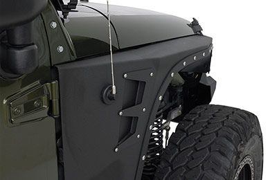

Ok, the snake running up the windshield looks cool but I'm not going to be going that deep, ever.So I have been thinking of doing a reverse hood scoop type of breather. But then I ran across these pics last night.
So I am wondering if it is something that would work well, using the space between the fender and inner to shield the intake from sucking in water.
That or this...
Like I said the big snorks look cool but it's more than I need maybe. Opinions on this please.

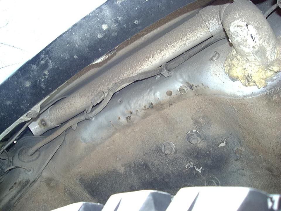

Last night I attempted to take the fender off. After the brush guard, turn signal, still I have to take off the bumper to get those last 2, the wife was like "not tonight buddy, drop the wrench and get in here, it's V day" lol. I get home about 10:30pm every night. She is used to me going straight to the garage until 2 or 3 am. So the fender dismantle had to wait. But I did get good view inside of the fender when the signal was out. It was clean and dry in there. So I took my heat gun and bent an old leaf blower tube to go into an access hole and fed it in the empty area. I then used a Rigid wet/dry vac dust filter to plug one of the other air holes that was next to it. It seemed to me like this fender was made for a hidden snorkel. Everything is there and in place. It just needs to be utilized. So I plugged the fender gap with a shop rag for now, foamed the pipe and masking taped the other air cleaner pipe. At this point I was on my second bottle of wine and couldn't find my gorilla or duct tape, lol I drove it to work and ran smooth so it is getting plenty of air from in there. I should get off work at 1 today so I am going to dip in the woods behind this Business Center and test it out. Any puddle makes my truck choke so I will see today how well the inner fender area works. If all goes well then I will start a permanent install, minus the leaf blower tube, lol.

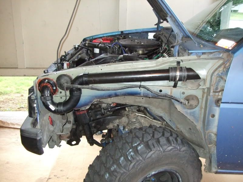

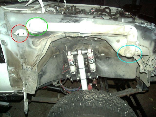

Yes Precise, those are awesome pics, and that's exactly what I am trying to do.That inner fender area looks perfect for this project
This setup is EXACTLY what I want to do. Thanks for sharing this!
If you go this route, Which worked very well for me for years (hey look my tires have tread on them in that picture!) Its very important that you retain your plastic fender liner and that it is in complete un-broken condition. Otherwise your tire will sling water and mud into your intake even on paved roads.
