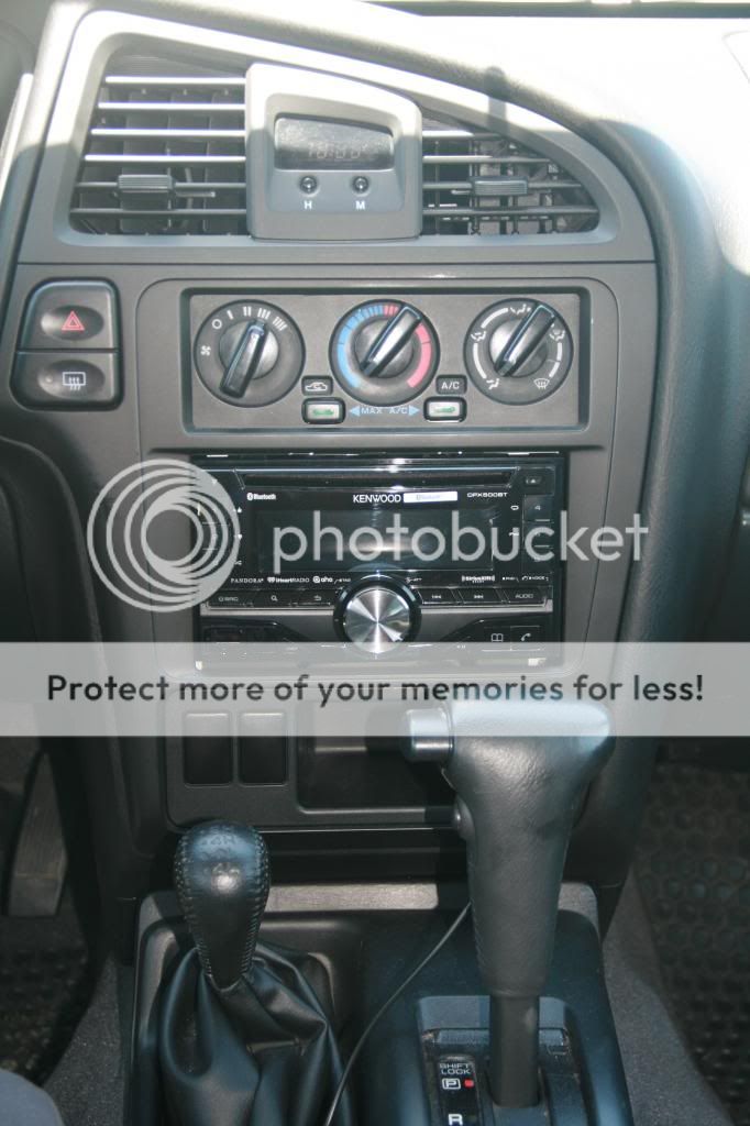

In reference to improving your pathy, you've come to the right place to blow money. :happy: For the stereo question- I have the Kenwood DBX500BT, which fit into the stock location with no trimming, does bluetooth, pandora, CD, Ipod, aux, whatever, and is adapted to the factory Bose speakers. Their sound quality has improved a bit, and overall I'm very happy with them. However, if you have the $$ you might as well upgrade your speakers, if that is in your ultimate plan.

I used both the dash adapter for a double DIN, and an adapter to connect to my factory speakers. I say you upgrade the speakers while you're in there, it makes things easier from what I understand.
