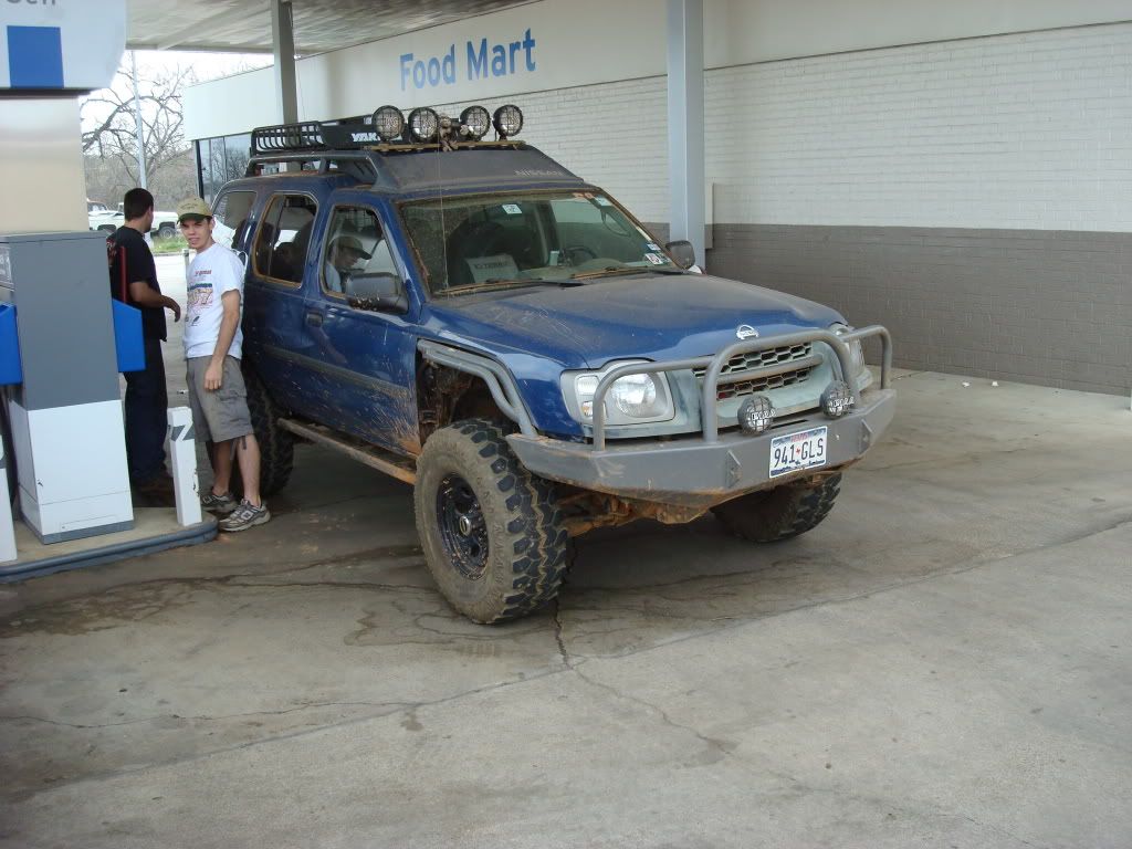

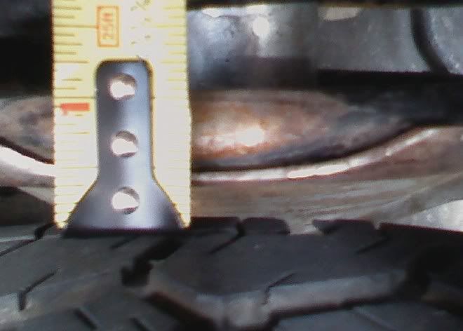

Yes they clear the stock strut, but not by much. Mine are 265/65R17 on the X rims, here are the pics without the spacers...
Then I added the 1.5" wheel spacers ONLY to move the wheels flush with the fender flares...
And now the X rims on the 01 with the wheel spacers...

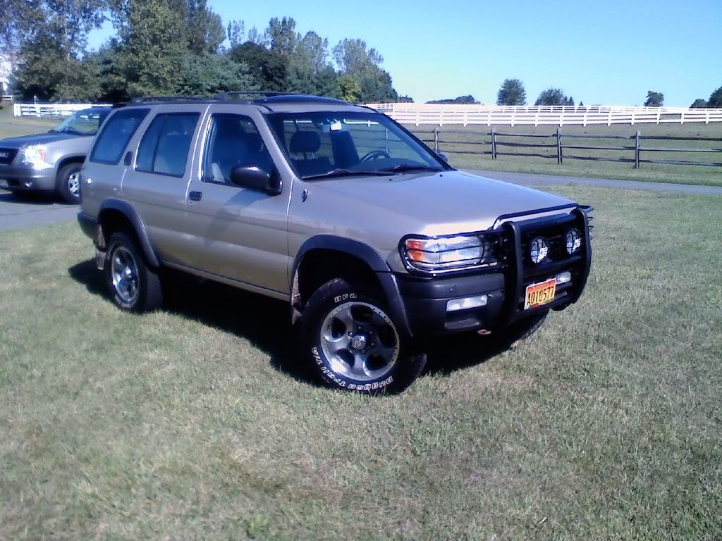

which le rims? mine are only 16 and i have 265/70/16, which is "almost" similar to a 265/65/17. i have no problems with rubbing.
some old pics with my blown struts and shocks, so the car sits a tad bit higher now. but everything else is stock.
