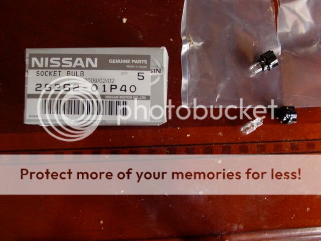

GoPathyGo Posted April 27, 2009 Share Posted April 27, 2009 Ok, so I have new and potentially important (from an electrical point of view) info. Asked about the bulbs at Nissan dealer today (was there for some other stuff). There are TWO different instrument bulb types for the 03 Pathfinder. The Brown Base for the Turn Signals and Full Beam uses a 74 Bulb but is rated at 1.4 W The Black Base for everything else is rated at 3 W. Luckily he had a pair of Black Base ones in stock. I took a look and, amazingly, the bulbs detached from the socket easily. Bizarrely, the Brown Base costs $18 (dealer price) and the Black Base $5. Both with bulbs! I bought 6! Maybe this is why that guys board started smoking ? He overloaded the bulbs or something ? I don't know. I guess it doesn't matter as much with LEDs (which are low power draw anyway) but may be important for incandescents. Link to comment Share on other sites More sharing options...
