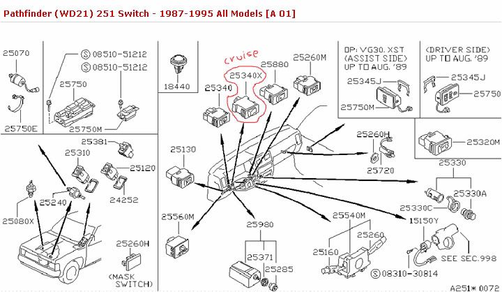

this is a diagram, and parts website from a texas, USA website. their parts are expensive, but it gives you an idea.
http://www.courtesyparts.com/betasite/path..._5611_5619.html
you also need the turn signal with cruise incorporated in it (link below), and you would need the on/off switch that mounts on the dash under the gauge cluster, and its harness (if not already tucked under the dash somewhere).
http://www.courtesyparts.com/Merchant2/mer...ode=25540-D21CC
http://www.courtesyparts.com/betasite/path..._5611_5616.html

Thanks for the diagram. The on/off switch on the dash is one thing I would need and possibly the wiring harness to go with it. I'll have to look. We are right hand drive over here and the indicator stalk is on the right side of the steering column. it appears from the link you sent that your turn signal stalk is on the left side with the cruise incorporated. I would have to see if I could adapt that.
From the parts diagram you sent me it does not seem that there is too much involved in the set up. It seems that it runs off the vacuum through the contoller? The basic mechanicals of it seem to be relatively simple?
