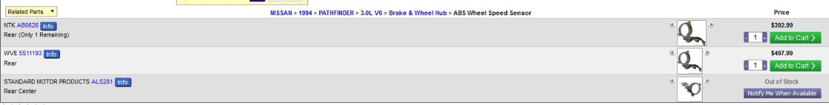

Negative - I have not been able to fix the odometer not turning problem - although the Digital trip odometer has worked sometimes again .. it also has stopped turning I am thinking the problem is at the Rearend -- ABS 47900-92G20 - Abs wheel speed sensor (rear) My ABS light is now on and my ABS is not working the part is very pricey - I think 300$ - not sure if Nissan can even get it anymore this is a serious problem - I have no idea how many miles i am driving - risk of running out gas - plus i still have the ignition problem and my gas gauge isnt working I just built a New Engine last year and I cant drive this anywhere because - no gas gauge / no odometer turning I can drive it to work and back - like 6 times then fill up - but I cant do road trips to go camping or to the beach - no mileage reading .. but i have an ignition problem - so thats #1 problem to fix right now this all sucks .. -

Ok I looked I See the ABS Wheel Speed Senor around the pinion How the Heck does that thing come off to replace ? Nissan tells me it is :91-95 Nissan Pathfinder ABS Control Module 47850 92G00 OEM https://parts.nissanusa.com/a/Nissan__/89924895__10618284/ANTI-SKID-CONTROL/D21_US_476A.html What does the ABS Wheel Speed Senor - DO ? What does the ABS Control Module - DO ?
Look at your rear axle and you will see it wrapped around the pinion on the axle. It's a pricy thing. https://www.rockauto.com/en/catalog/nissan,1994,pathfinder,3.0l+v6,1211960,brake+&+wheel+hub,abs+wheel+speed+sensor,1912 Now I am wondering if the ABS Wheel Speed Senor is BAD - that is effecting BOTH the ABS ( light on ) and now not working along with the Odometer Not Turning
