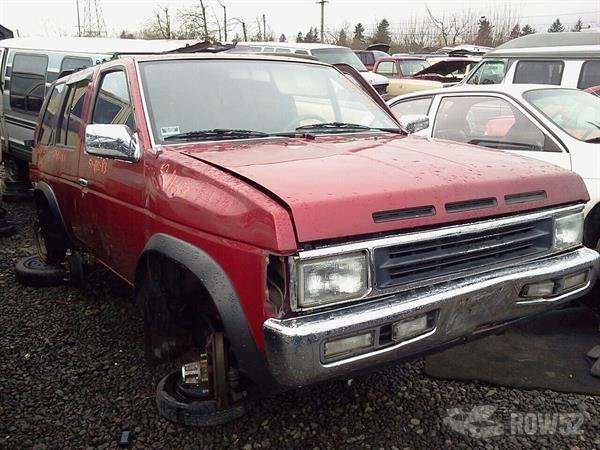

(Found a set of Warn Hubs on a Pathfinder at U-Pull-It, Too bad I just bought brand new ones).
Every fog light I have seen as the lens cracked. (Mine do)... I was going to replace mine with some LED units. I do like the white lens, I didn't notice if those are still on it.
