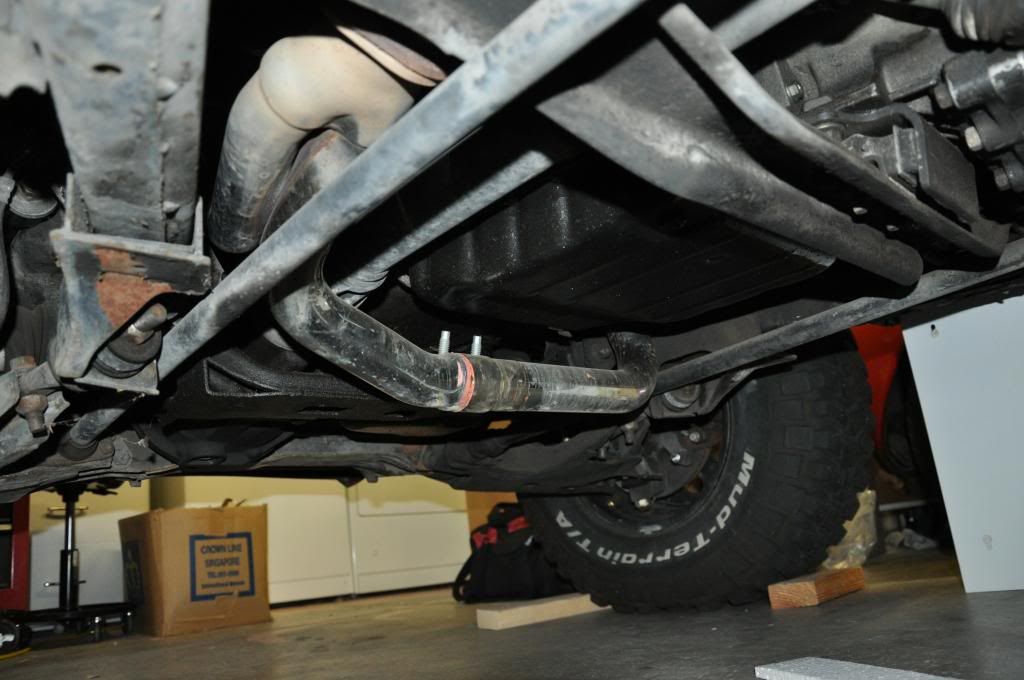

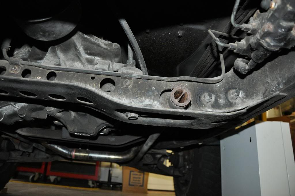

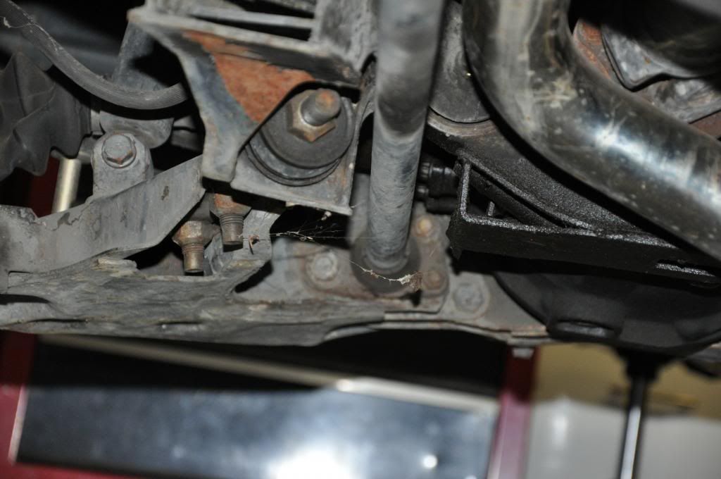

Well, here we go. I hope these pics. give enough info. on the 2WD/5-Speed header options. My measurements on the TB's are 40+ inches long and they are equally spaced 20 inches both front and back.

Here are my thoughts. It looks as if either EE and DT Headers should work because of the location of the collector. However, they are pretty pricey for the amount of power you get back from them. In reality, I was hoping that the OBX Headers would fit with no problems because of the price ($185.00).
Thanks for posting decent pictures, you wouldn't believe the pointless crap people post with the disclaimer of 'sorry for the crappy picture', rather than go take a decent one... :rolleyes:
Ok, that is completely different! For starters, my T-bars are 24" center to center, front and rear. I forgot to measure the length but that shouldn't matter...
It looks to me like the cross over and the Y pipe would need modification because the T bars aren't more than an inch to the outside of the pipes.
Ok, so your call from here on what you would like better pictures of, or what measurements.
B
Good pictures as well sir. From what I see here, it looks as if both the EE and DT headers will fit to the block & chassis without too much drama. The hard part is where the Y-Pipe comes into play, if at all. I would think a high end exhaust/muffler shop should be able to handle the job well enough.

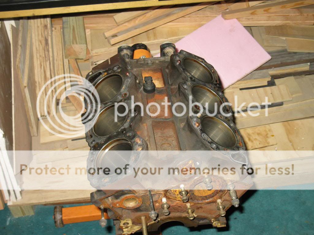

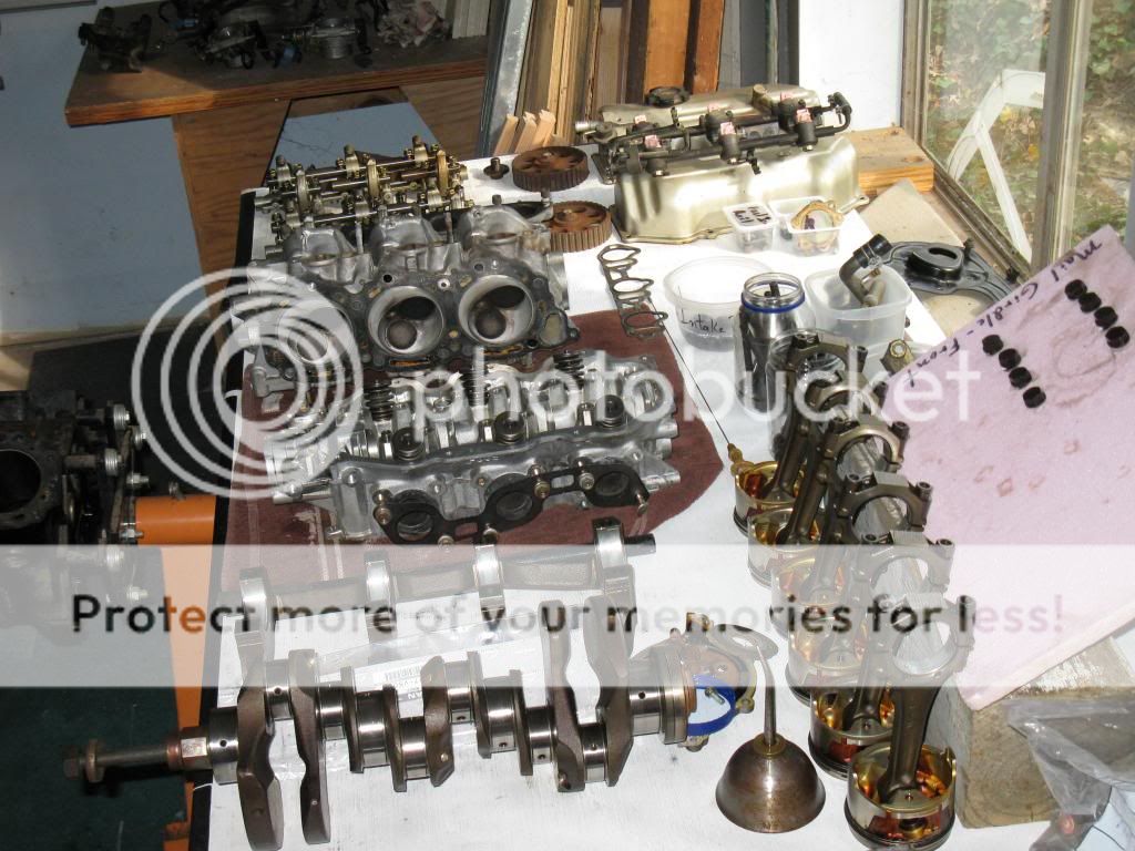

I have a replacement motor that's torn apart ready for the machine shop ( complete rebuild ) w/ soon to be Ported and Polished heads, new valves, valve springs,...the whole nine yards. Pistons, crank, etc. ( I'll take pics of my work area ).

Here'w where we're at. The original motor has a spun rod bearing. The replacement motor has a bad crank ( broken snout and bent ). This motor will under go a full rebuild with original crank turned down and new, upgraded internals will be installed with the reground cams that I just got in today. The specs. on the cams are 264 dur. - .450" lift - 114* LSA. This explains why the header choice is so important.
