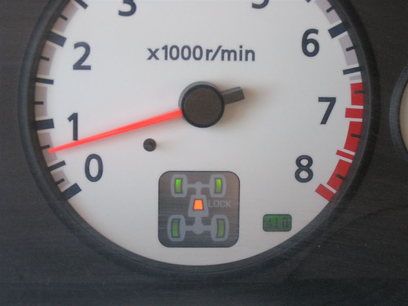

Howie Posted March 7, 2012 Share Posted March 7, 2012 I think the 4LO indicator is only on the AWD systems, not the part-time 4WD systems (transfer shifter on the floor, as opposed to a console switch). I have a manual transmission with manual transfer, and I don't have the 4LO light (I never did, and I had this car since brand-new). I only have the 4WD icon and that's it. I can tell when I'm in 4LO by the position of the transfer lever. If you read the manual carefully, they state the 4LO indicator is when the transfer SWITCH is in the LO position (not transfer lever). Link to comment Share on other sites More sharing options...
Rick13 Posted March 7, 2012 Share Posted March 7, 2012 (edited) I think the 4LO indicator is only on the AWD systems, not the part-time 4WD systems (transfer shifter on the floor, as opposed to a console switch). I have a manual transmission with manual transfer, and I don't have the 4LO light (I never did, and I had this car since brand-new). I only have the 4WD icon and that's it. I can tell when I'm in 4LO by the position of the transfer lever. If you read the manual carefully, they state the 4LO indicator is when the transfer SWITCH is in the LO position (not transfer lever). 2001 LE (w/Auto Mode all wheel drive) "shifted" in to 4LO: Edited March 9, 2012 by Rick13 Link to comment Share on other sites More sharing options...
