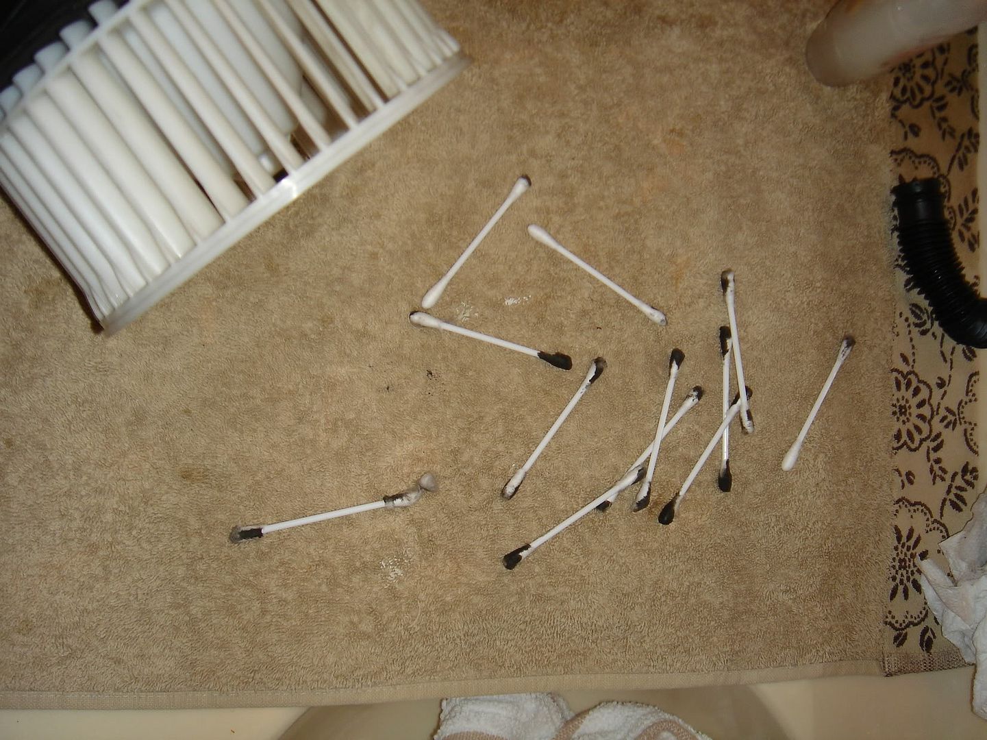

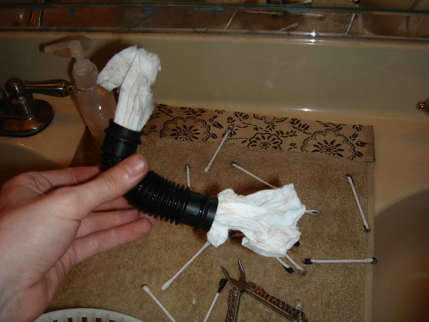

Towncivilian Posted December 31, 2011 Share Posted December 31, 2011 The blower motor will look something this (all these pictures are from an R50 so expect some differences): Clean the blower motor and its housing while you have it removed too... Blower motor housing, before: Dirt: Clean housing: Blower motor cage: Since there are so many fins, cleaning each and every one thoroughly would be an extremely time consuming process. I decided to run the fins under the sink, spinning the cage with my fingers quickly to remove most of the crud. I then used Q-tips to get most of the remaining crud off: I also detached the small tube, rinsed it under water and ran a paper towel through it to grab more crud and dry it: 1 Link to comment Share on other sites More sharing options...

1994SEV6 Posted December 31, 2011 Author Share Posted December 31, 2011 The blower motor will look something this (all these pictures are from an R50 so expect some differences): Clean the blower motor and its housing while you have it removed too... Blower motor housing, before: Dirt: Clean housing: Blower motor cage: Since there are so many fins, cleaning each and every one thoroughly would be an extremely time consuming process. I decided to run the fins under the sink, spinning the cage with my fingers quickly to remove most of the crud. I then used Q-tips to get most of the remaining crud off: I also detached the small tube, rinsed it under water and ran a paper towel through it to grab more crud and dry it: Thanks. I had this idea that the blower motor was somewhere much more inconvenient to get to. I thought the resisters were right there and the blower was somewhere else. Link to comment Share on other sites More sharing options...
