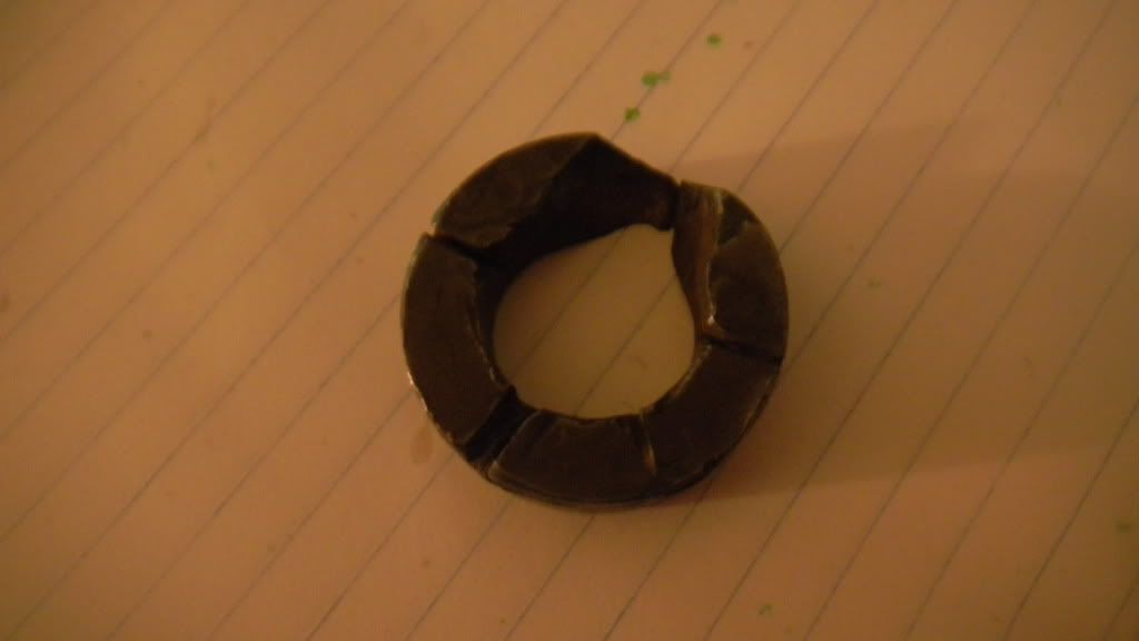

2-3 hours of banging, prying, slide hammering, dry icing, torching, hydraulics, and then cutting it finally came out of my engine. Hopefully you have better luck as they should just pop out with a slide hammer or bushing puller if you can find one small enough. Mine was just rusted on solid + being press-fit from the factory.
Make sure you don't forget the pilot bushing when doing your swap. You'll hate yourself for having to pull the engine or transmission out again over a ~$2 part. I sure as hell did. Without it the front of the input shaft has no support so nothing is aligned well making gears grind like mad.
They can be a real bitch.
LOL.. Been there! I now weld a 3/4 inch bolt to the bush... then smack downwards on the end of the bolt sticking out with a sledge hammer.. Pops it out like a playing a game of Tiddlywinks...
