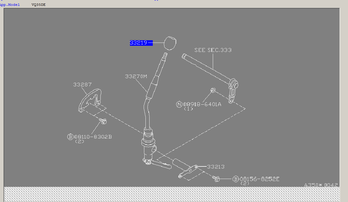

Brnjac Posted March 6, 2019 Share Posted March 6, 2019 Also, not sure if this is the right plate to post this. But if anyone needs a diagram of the TC shift linkage to help troubleshoot like I did. Here is this: Link to comment Share on other sites More sharing options...
