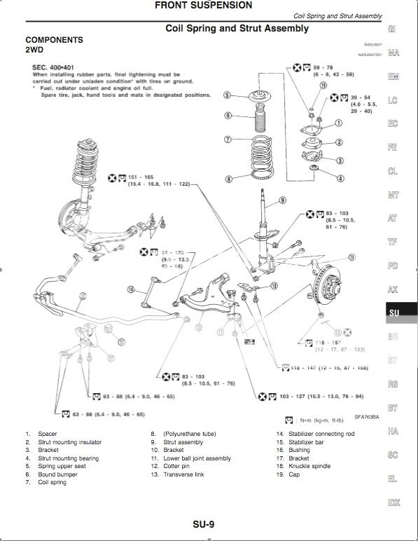

Geoff57 Posted October 18, 2008 Share Posted October 18, 2008 (edited) Pete Was the large plastic washer that sits between the top of the strut shaft and the rubber mount plate still there? This washer acts as a bearing surface and allows the strut to turn easily. Without it the strut will still turn but there is a lot more drag which I imagine will eventually cause damage to the rubber. Geoff Edited October 18, 2008 by Geoff57 Link to comment Share on other sites More sharing options...
PDCCD Posted October 18, 2008 Author Share Posted October 18, 2008 Pete Was the large plastic washer that sits between the top of the strut shaft and the rubber mount plate still there? This washer acts as a bearing surface and allows the strut to turn easily. Without it the strut will still turn but there is a lot more drag which I imagine will eventually cause damage to the rubber. Geoff Hmm. Well, there's the "spacer" that's a red color that sits between the top of the strut assembly and the fender. Is that it? Or should there have been one between the nut at the top of the strut and the rubber "strut mounting insulator"? I didn't see any washer under that strut nut in the service manual. thanks for the help. Pete Oh, and where'd you get that Lokka locker in your front axle? Is that common in Australia? Want to export one by any chance? Link to comment Share on other sites More sharing options...
Geoff57 Posted October 19, 2008 Share Posted October 19, 2008 (edited) This washer sits on top of the spring holder plate and is around 1-1/2 to 2 inches in dia. The shaft comes up through it and into the rubber mounting block. This washer has all the weigh of the vehicle sitting on it and its job is to allow the spring mount plate (and the rest of the strut) to turn. Without it, the inner metal part of the mounting bush would be rubbing directly on the metal top of the spring plate which would soon destroy the rubber. Lokka diff kits are sold by 4WD systems located in South Aust The export around the world according to their site. http://www.4wdsystems.com.au/html/lokka.htm The modification to the diff gears can be installed buy anyone with at least a bit of mechanical knowledge and access to a good set of tools. I have had mine for 6 years and was in my previous R50 ( I swapped the complete diff housings over) Geoff Edited October 19, 2008 by Geoff57 Link to comment Share on other sites More sharing options...

Geoff57 Posted October 19, 2008 Share Posted October 19, 2008 (edited) Geoff is talking about the strut bearings...you have already determined Pete, that OEM is the ONLY way to go!! KYB replacements are just poo. I recently replaced (thanks SammyB), my front insulators and bearings and struts...the world is a much smoother place now!! The only catch to my replacement is that I have a noise that sounds like a "light" topping out by my struts...not quite as lud as bad sway-bar end links going bad...any suggestions here?? ***Geoff, good call on the strut bearings, but several of us R50 owners already learned about these the hard way!!*** It sounds like our Oz R50s use a different mounting block to yours or are you guys fitting an aftermarket mounting block that has a bearing mounted in it ? There are no bearings in our mounting block just a steel sleeve moulded to the rubber. The strut shaft fits into a keyway in the steel sleeve to stop it turning and is secured by a locknut on top. The strut shaft doesnt rotate, rather the spring mounting plate (and the rest of the strut) rotate around it. The plastic washer is sandwiched between the spring plate and the bottom of the mounting block and acts as a bearing surface. Pete, I still use the factory LSD in the rear. Combined with the Lokka up front it works well. While it may not have as much traction as an air locker ,you dont need to think when to engage it. We used to be able to get Japanese performance parts in Oz up until 1999 when the federal gov banned the importing of Jap second hand vehicles that had an equivalent vehicle sold new here. This was to protect the resale value of the Oz delivered vehicles. There where a lot of parts being imported with these vehicles to support them. But since the ban not many companies bother to bring them in as there is just not the demand without the vehicles. It is a pain because I would have loved to have imported an R50 fitted with the ZD30 intercooled turbo diesel which are a really great truck. Geoff Edited October 19, 2008 by Geoff57 Link to comment Share on other sites More sharing options...
PDCCD Posted October 19, 2008 Author Share Posted October 19, 2008 It sounds like our Oz R50s use a different mounting block to yours or are you guys fitting an aftermarket mounting block that has a bearing mounted in it ? There are no bearings in our mounting block just a steel sleeve moulded to the rubber. The strut shaft fits into a keyway in the steel sleeve to stop it turning and is secured by a locknut on top. The strut shaft doesnt rotate, rather the spring mounting plate (and the rest of the strut) rotate around it. The plastic washer is sandwiched between the spring plate and the bottom of the mounting block and acts as a bearing surface. Pete, I still use the factory LSD in the rear. Combined with the Lokka up front it works well. While it may not have as much traction as an air locker ,you dont need to think when to engage it and it doesnt try bulldozer your vehicle into going in a straight line. We used to be able to get Japanese performance parts in Oz up until 1999 when the federal gov banned the importing of Jap second hand vehicles that had an equivalent vehicle sold new here. This was to protect the resale value of the Oz delivered vehicles. There where a lot of parts being imported with these vehicles to support them. But since the ban not many companies bother to bring them in as there is just not the demand without the vehicles. It is a pain because I would have loved to have imported an R50 fitted with the ZD30 intercooled turbo diesel which are a really great truck. Geoff No Geoff, i don't think it's a parts issue, just vocabulary confusion. If you can see with my attachment, part #4 in this schematic is called a strut mounting bearing, which essentially yes, is just a couple of plastic washers with some lubricant in between that allows the assembly to rotate. Washer, bearing, pain in the ass, it's all good LOL. It sucks you guys can't import the parts, i think it could be argued that a R50 with a ZD30 is not the same as a R50 with a vq35. I've got to make some japanese friends. Link to comment Share on other sites More sharing options...
