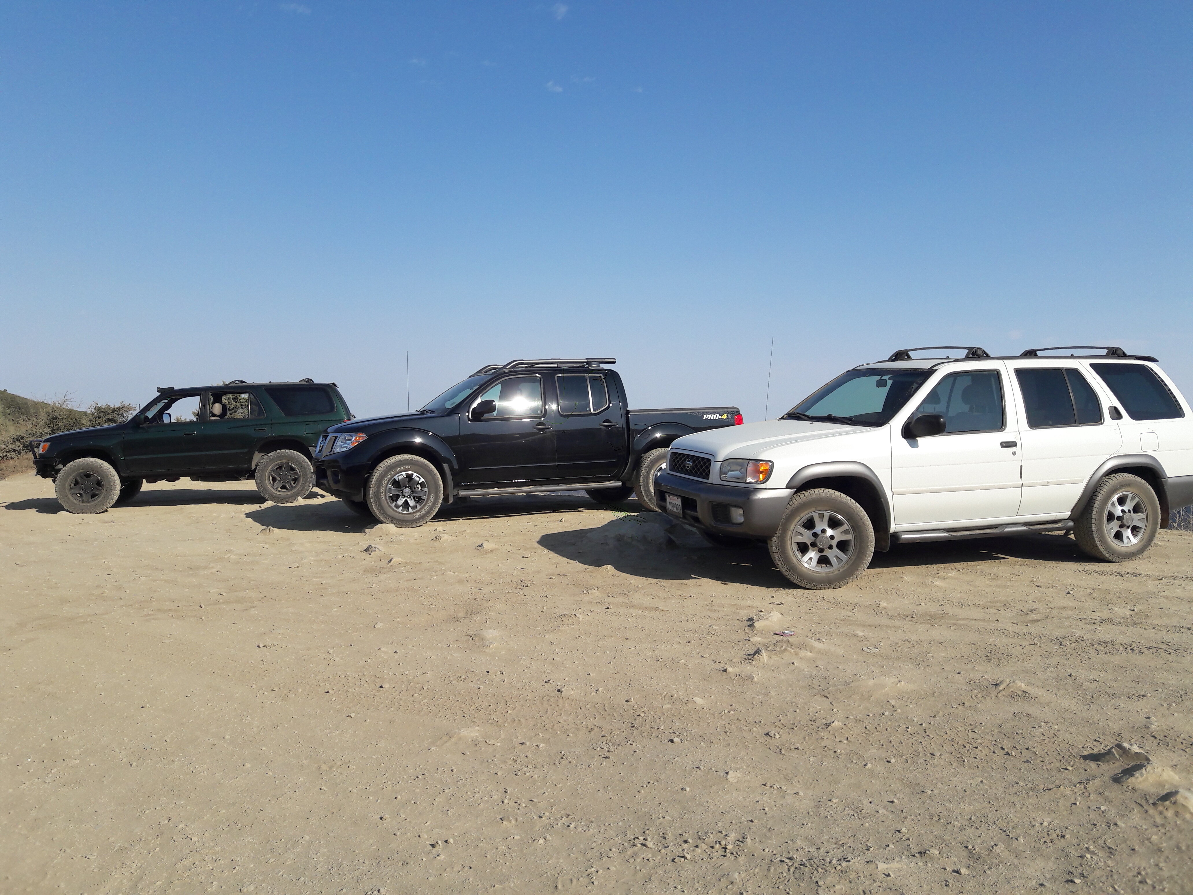

Does anyone take their rwd pathy offroading? My pathy rwd and has a set of A/Ts, but I am concerned of it having issues since it isn't 4x4.
I wonder..based on his profile pic it looks like his pathy is lifted and on bigger tires - My pathy has a/t but nothing else, it pretty much stock, so i will probably just go OEM or something to that regards
