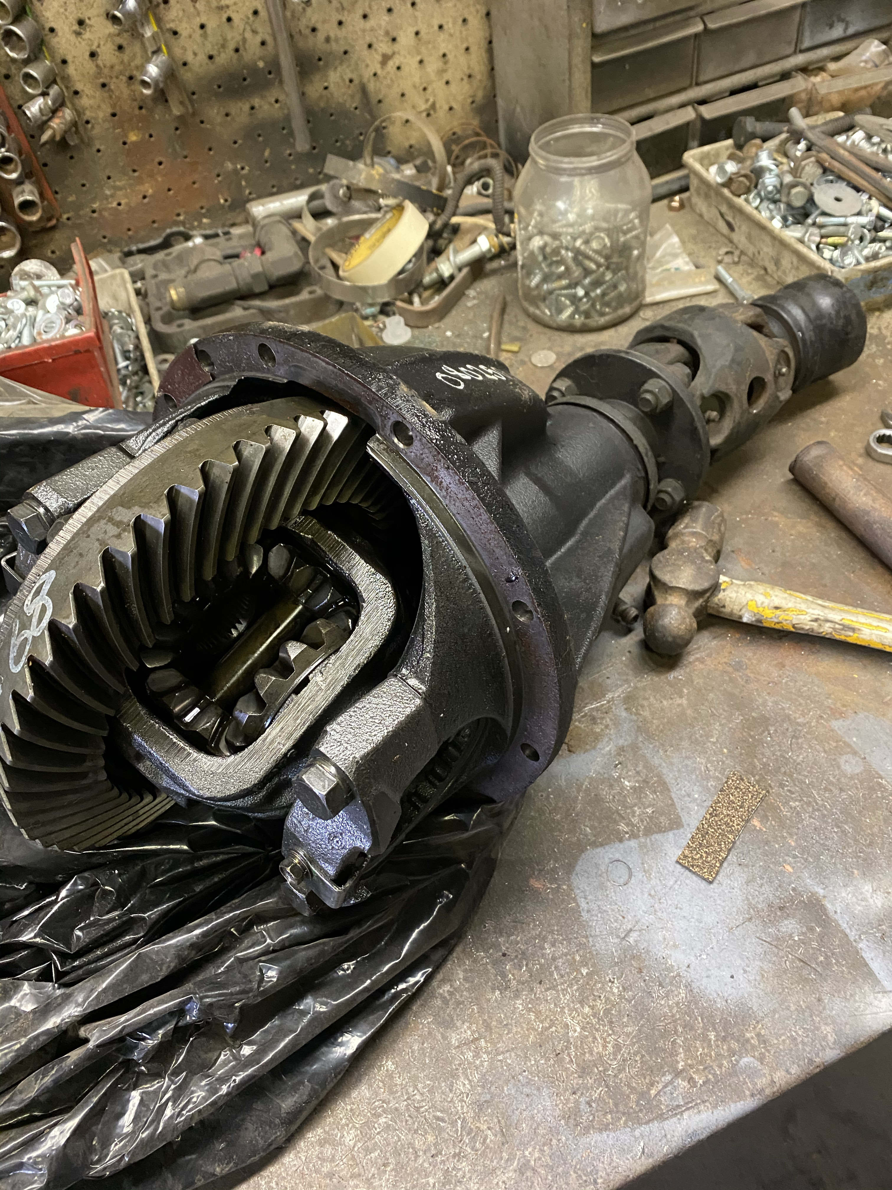

So many months later. I have torn down the LSD my original differential fearing a impending failure. All bearing appear good. Races no feel able lip or gouges. It appears to be the metal holder things inside the LSD have started to get eating up over the 200k mile life it’s had. [emoji848][emoji848][emoji848] What todo. It’s coming in to holiday season and moneys tights. Snows a coming and I would like to be more confident in the truck with 4wd and matching gears.

Ok so we can toss the idea of the lock right out maybe some day I’ll get a air locker. [emoji13] And so I should swap this diff out so it don’t explode on me. Then I’ll have to decide either rebuild diff I have. Depending on damage carnage inside. Or buy the one from eBay that is if the item is a 4.6 xterra LSD - and to buy it whole for the full $365 for the whole unit or just get the guts for $300. I suppose $65 might be be worth the possibility and pain of improperly setting gear backlash and such. Plus the pressing in and out of bearings of housing. I do tend to learn the hard way and slowly. Why do it right once. When you can do it wrong TWICE. [emoji12][emoji848][emoji848] Fairly confident it’s that pinion bearing on the inner side. I’d think that’s the one which takes the most load. But it could be the axel shaft side bearings.

Made it 1139 or so miles. Made my trip and returned. Then today coming home from work it made a terrible noise and screech for about 30 seconds then slowly went away. .. I am starting to think it’s the in pinion gear bearing. [emoji2957] but she is surely on the wayyys out.
500 miles down ! Made it. No crazy noises. Thanks for advice. Think 11k miles ago I didn’t put in LSD oil [emoji51] post the wheel falling off. And there was a strange noise when turning that it would make for a little. The pan wAs dirty. The big bits of black crap where there u was just taking about the metal chunks. Thinking more about it I prolly did damage the LSD. There was a lot of fine metal particle in the oil
