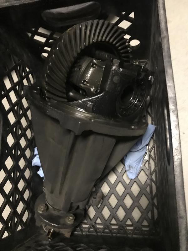

Honestly, if you're in Stockton, I wouldn't even bother with that eBay unit.  Pricewise, $300 for just the internals on that eBay unit is a rip.  I just bought a full 3rd member with LSD and a pair of axle shafts last weekend for $210; my yard typically charges $150 for the complete 3rd member, and I've bought a few in the area for about the same price.  Took hand tools and <30 mins to have it out, as you probably know.
Not sure the supply of yards in Stockton, but there's a ton of them in Sacramento, especially in a pocket in Rancho Cordova.  There used to be a "Nissan Only Wreckers" group there, but I think they are now Rancho Nissan Auto Dismantling.  But that little area they're in has several other yards right there on the same street.
Even if you don't pull it yourself, they'll pull it and warranty it for under that $300 I'm sure, in addition to having a large selection.  If you're being picky, you'll ask for an LSD unit from a 00-02 Xterra V6 or 01-02 Frontier V6 with HG46 gears, since those will have the best LSD setup for a unit that'll bolt right into your truck.  The 4.636 gears will be stamped with "51:11".  The 2wd units may have the ABS sensor on the snout (see below)...you can just ignore that; the overall snout length is the same as the units without the ABS sensors (our sensors are on the axle housing ends).
This is the LSD unit I just pulled the other day, from an 02 Xterra 2wd.
0-DFCCC6-C-3-A91-430-E-83-C8-B8999-F7590
LSD carrier (I have a couple units that aren't in the 3rd member if you need additional pics):
54-FDB012-F571-4-AA1-91-B2-F0678-D129-E4
