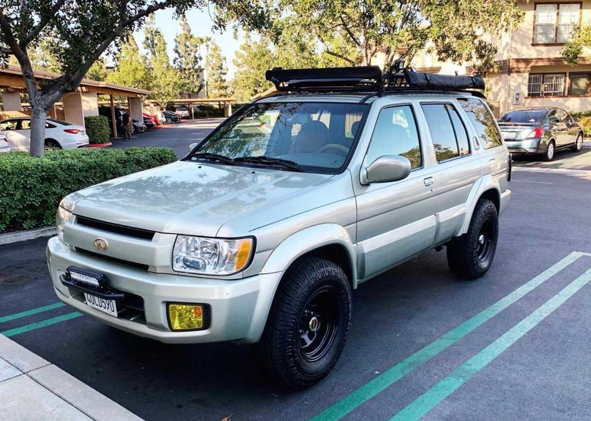

very nice! let see it
Here it is! Still a big work in progress but it cleaned up really well for something I picked up for 1800 bucks. I also own a 2014 3.7L Mustang but my QX4 is way more reliable. 1201826617_Qx4Pic(1).thumb.jpg.ba9b1a358727b9c8d05d1e45a02b62bf.jpg
Man 1800 for that... is nice. I got mine for 19 and it ddnt have racks or nice wheels... good find.
Thank you! It was actually bone stock when I bought it. Was used by as a Mall Crawler. It was throwing a code for a camshaft position sensor and the guy who owned it before me took it to the dealer and they quoted him 1300 to replace both sensor and solenoids which is why he was selling it since he couldn't get it smogged with the code. He wanted 2200, I offered 1600 we agreed on 1800. 10 minutes and a $80 sensor from O'reillys later and the code was gone. All other mods were done by me. Probably put in 3000 in maintenance and mods including lift, wheels tires, etc but it runs like a dream, knock on wood.
