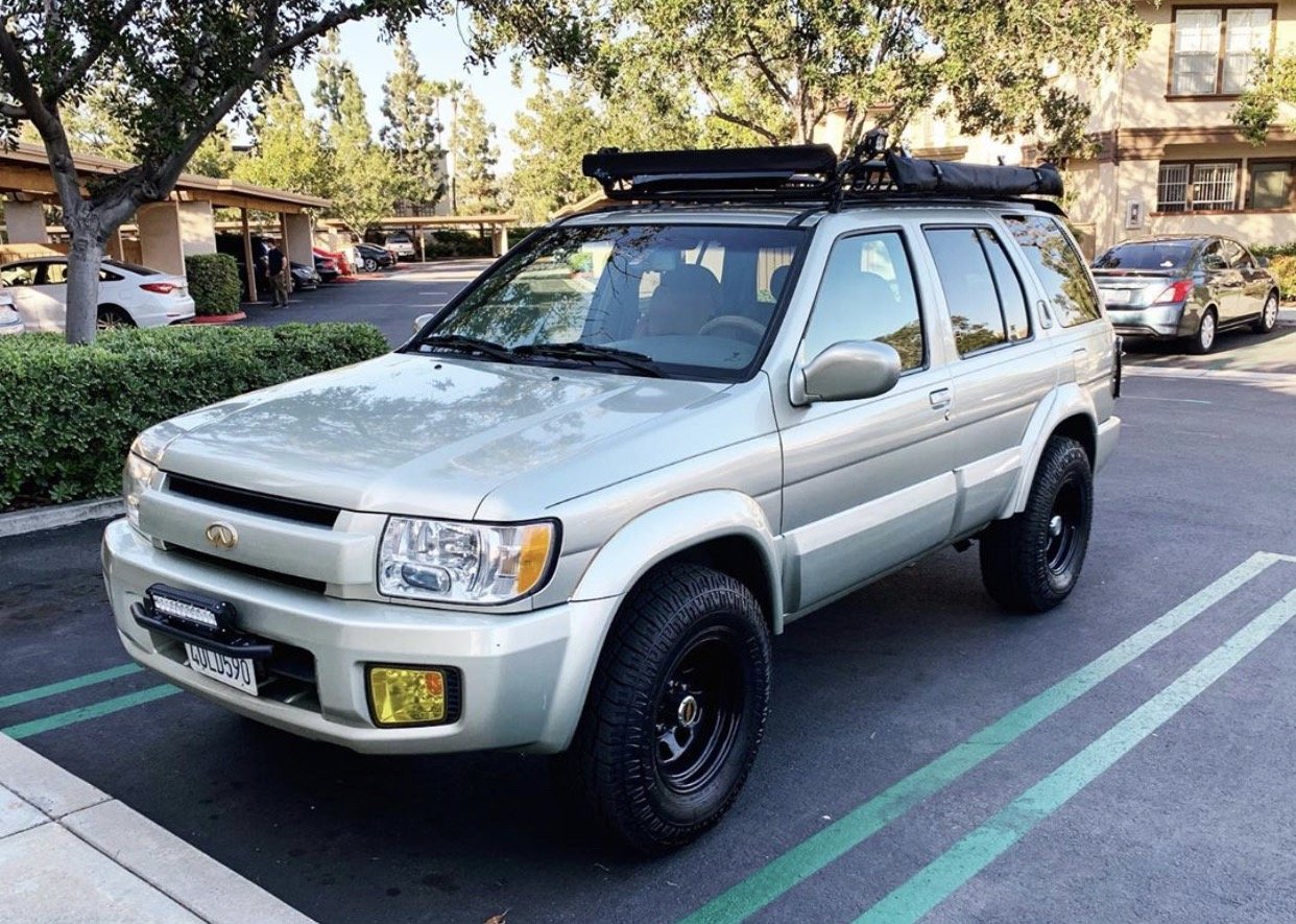

Here it is! Still a big work in progress but it cleaned up really well for something I picked up for 1800 bucks. I also own a 2014 3.7L Mustang but my QX4 is way more reliable. -
Hi Micfly, I just picked up a 2001 QX4 with 173K miles in January and have been modding it since. I'm located in Tustin, CA and have also been trying to find people enthusiasts in the area. I am unsure if the roof rails on the Pathy are the same but I found a solution that I saw another owner do somewhere. I removed the factory roof bars and the washers inside the rails. I used bolts to to go through the bottom of those washers and then slid them down the rails evenly on both sides. I then picked up 8 conduit hangars from local hardware store. I placed the hangars with opening facing upwards and then used nuts to tighten them to the rails. You should have 4 clasps on each side running down the car. I bought the ROLA roof rack which turns out is exactly the same width as roof rails on the QX4. From there, you just bolt the cups of the conduit hangars shut. It's surprisingly solid and i've used my entire weight tugging on the roof rack and it moves the entire car as though it was one piece. let me know, i'd be more than happy to show you what i've done.
