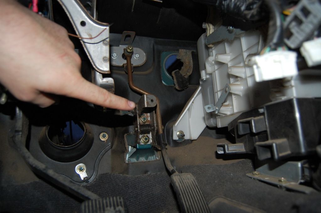

DSC_0094.jpg That is the area where mine was on my 97. The big hole is where the wire loom goes thru. As you can tell there is NO ecm there at the moment. Shouldnt be any different on yours. Edited by linkinpark
The last photo (finger pointing to an empty space above the accelerator) is an incorrect indication of the location of the ECM.
The drawings in the preceding post show the correct location of the ECM.
Well that general area is where it is. That diagram to the left show it to be where all your air control units are. Which would be wrong. It is to the left of the heating and air.
