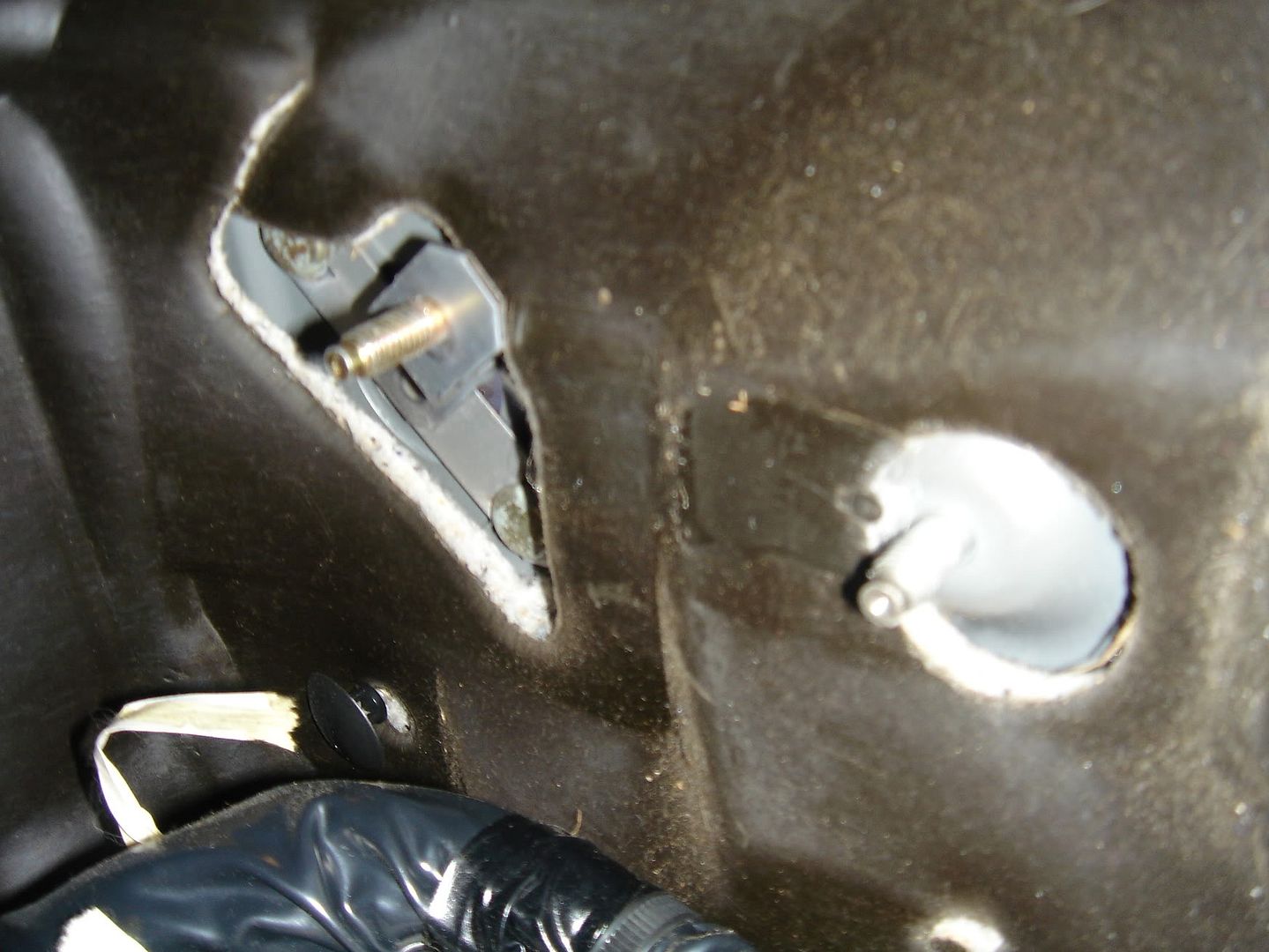

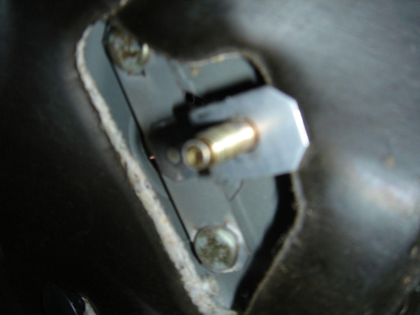

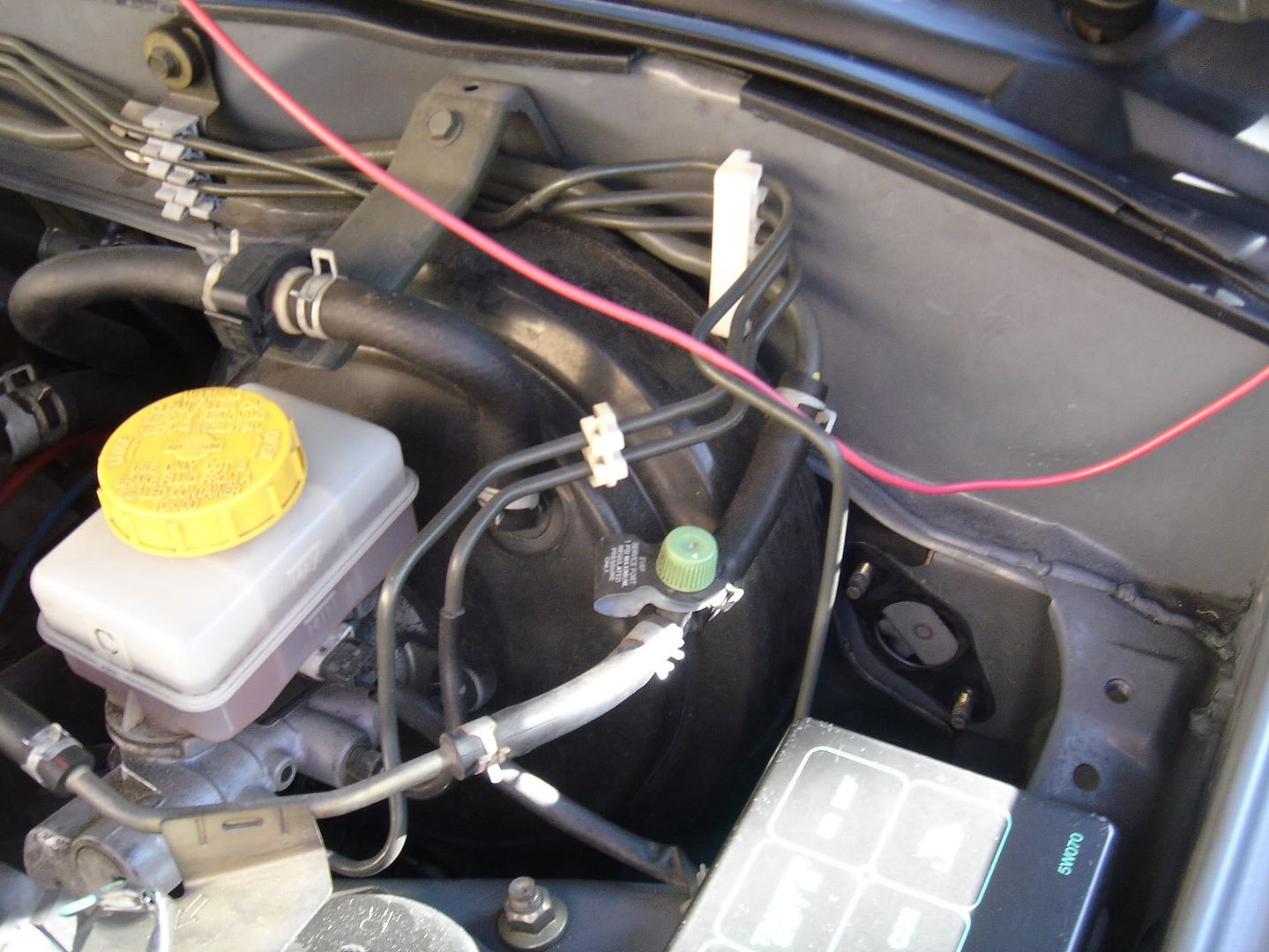

Towncivilian Posted March 13, 2011 Author Share Posted March 13, 2011 Here are some pics, with the plate removed: Inside: (this has the transmission computer installed, but not secured) Hope that helps. I'm having a hell of a time trying to find a 5/16" rubber grommet. Harbor Freight has a set, but they're sold out, and both Lowes and Walmart don't have any. Will have to check at Home Depot or wait for HF to get stock of it, or just drill a larger hole; I saw a 3/4" neoprene grommet on the Home Depot site. Unfortunately the only metal drill bit I have is 5/16". Link to comment Share on other sites More sharing options...

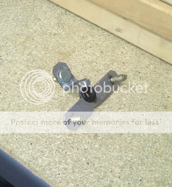

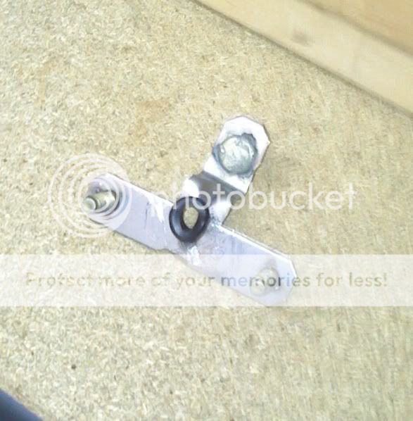

scott3606 Posted March 13, 2011 Share Posted March 13, 2011 What a coincidence... I'm installing a trailer brake control this very weekend, and took a few pic's of how I modified that bracket to accomodate a rubber grommet... Above is a side view... Here, you can see that I drilled the 1/2" off-center, so as not to break the spot-weld... Finally, you can see that i drilled my 1/2" hole in the outer plate, so that it pretty much lined up with the hole I drilled in the bracket... sjm Link to comment Share on other sites More sharing options...
