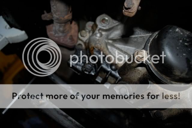

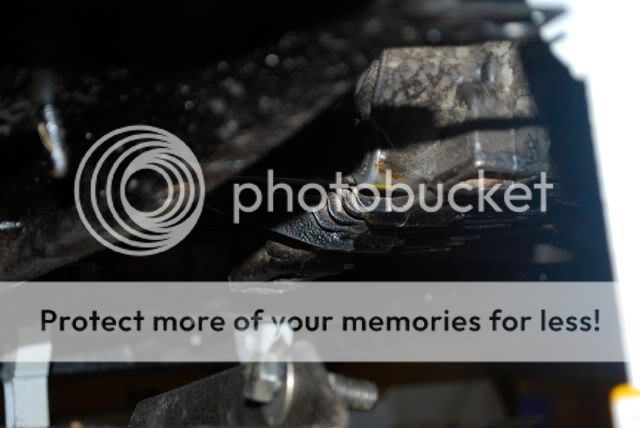

For reference, here are the drain and fill plugs I found. With the skids and all the rubbish in the garage it was difficult to get good shots but you should get the general idea:
Fill plug in top center of pic, rear of t-case facing the back of the truck. It's between the rusty clamp and the rusty cat pipe at the top of the pic.
Drain plug at bottom of case, front of t-case facing the front of the truck. Has a little yellow mark underneath it.
