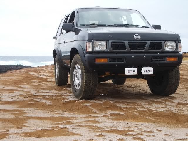

I got the IPF headlights from Quadratec. I had to convert to the D21 front end, but that was a bonus.
The hood and headlight bracket camr from Partstrain.com.
Hood: $95, Brakets: $18 each
The headlights and bulbs came from Quadratech.com.
IPF Rectangular headlights: $80 (pair)
IPF "Fatboy-super-low-beam bulbs: $75 (pair)
The difference is astonishing!
The headlights are engineered very well, and throws the lights better than regular Rectangular housings.
The bulbs are not rice-rocket blue...but the light is a little whiter than normal halogens. The high beam is really bright, but the low-beam is just amazing. The best thing about the bulbs is that they're not high-wattage...won't attract the cops, piss other drivers off, and won't fry a stock wiring harness. The bulbs are 60w I think.
I would do it again
