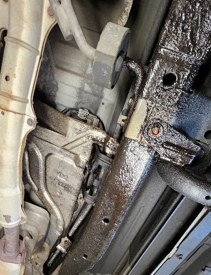

I'm debating on just hole sawing into the floor board to replace that sensor. I mentioned before someone had similar issue and just cut into floor board to get to that sensor to replace. If my leak gets worse I'll just do that. Just not sure how to run the new wire since it won't be in that wrapping. Link below
Thank you for the feedback. When looking at the leak. The drip is coming off the small burgundy colored plug on end closest to rear of car. Very slow but drips a drop or 2 a day.
Thank you for the tips. I had seen a couple others with similar leak state it's the sensor on top of tranny. Plug closest to front of car seems to have the drip. I saw one guy hole saw a spot under dash to get to thst sensor to replace. Seems like that could be a bit of an easier if not messier route to address it. I'm thinking of going that route to save the headache of dropping transmission. Leak isn't super bad currently so kinda holding off for now but I know it's inevitable. Tranny slips into 3rd gear when cold and have the rear main seal leak so the trifecta is nearly complete lol.

Hey all. I was installing my rear lift springs and noticed a leak of red tranny fluid. What had me confused is the drip migrated to passenger side frame. Drip collected a few inches ahead of muffler on frame. There's a plate covering wiring and I felt up there and wires seemed wet with fluid. Only owned this a few months and seems it just recently started dripping. Not sure where to start. Any advice is appreciated. 2001 LE 4x4 167k
