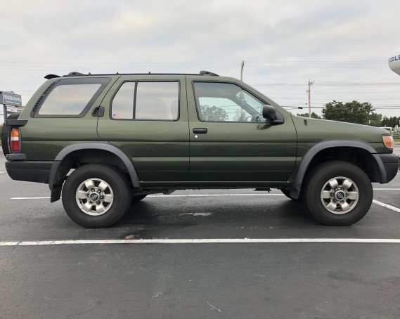

Sadly don’t have before pictures I seem to have lost them. But if anyone is trying to find out what a 2.5 inch strut lift will look like on their pathy, I hope this helps. Also to note if you do use 2.5 inch strut spacers, you’re going to have to use camber bolts. Something I haven’t don’t yet but will get around to. Hope this helps!
Lifted R50 with 2.5inch strut spacers front camber issues

Wanna make clearance with 33’s hoping I won’t have to do any metal body trimming. Is that possible? Still using 15inch rims/wheels. Current tire size is 265/70/R15 uses a 2.5inch strut spacer to lift it.

Lifted my 96 pathfinder with some 2.5inch strut spacers and got all new struts and front axel. Issue is got it aligned thinking it would fix my camber issue as well but they told me they couldn’t adjust it. Tires are cambered in and just need help on what to do next. And will I experience any issues down the road? They’re barely noticeable.
