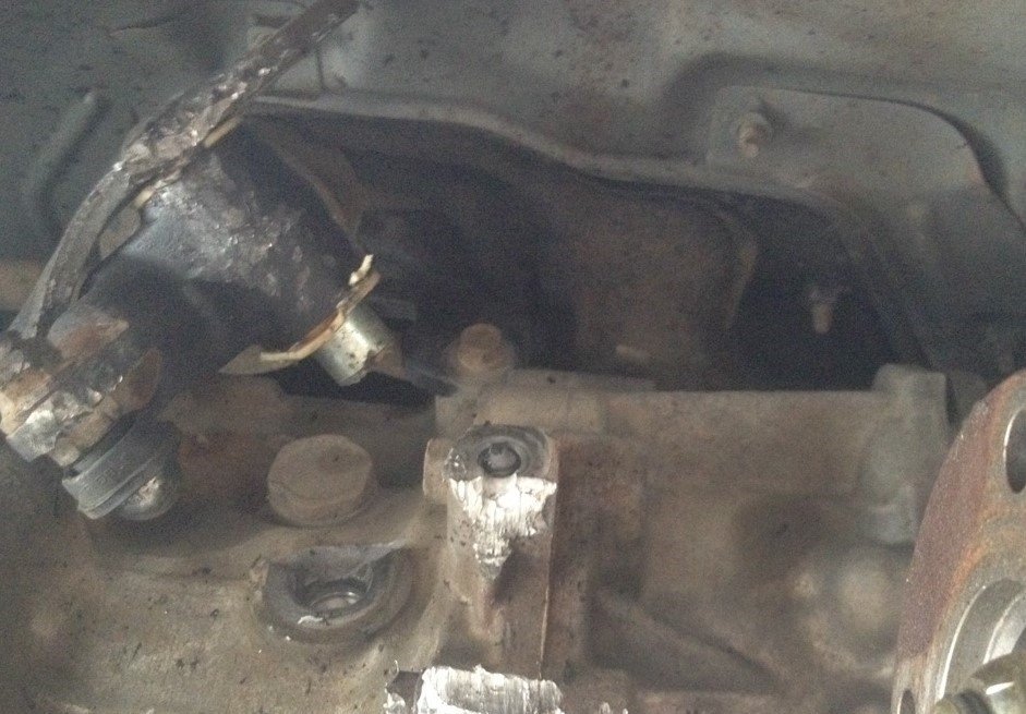

Hey Guys and or Gals, Looking to see if I am up that one creek without a paddle. Seeing if there is a way to save my T-Case. Long story short I was tracing a shimmy and the shimmy beat me to the punch. Blew linkage, drive-line in the rear u joint and smacked the ish out of my T-Case webbing. No leaks or gaping holes just the linkage is the issue. Anyway to salvage this?
