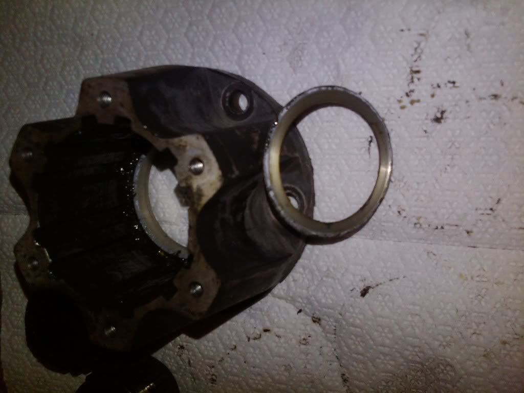

Alright so here's the skinny on this one...I shattered a hub on my truck in CA and kept all the pieces...I bought some from a guy who sold me the wrong set he sold me a 27 spline set and I needed a 28 spline...(Don't get confused about the details of my truck b/c it is an 87 truck but i need the 28 spline hubs since my truck is a 95 2 door) So being the engineer I had a feeling that everything was the same in these hubs except for the spline center...long story short that's a true statement.
I didn't read and I thought I saw a spring washer but didnt mess with it...I took the assumption it would just press out...bad idea I broke the casting and then verified I needed to pull the spring washer...so lesson # 1 DON'T TRY TO PRESS OUT THE SPLINED GEAR

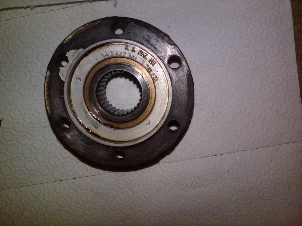

28 spline vs 27 spline...I cant even remember which was which:
Same story:
Don't press it out:
Step 1:
remove cap
Step 2: remove spring retainer washer and the gear will then come free of the bushing be sure not to loose the flat washer on the inside of the housing but its probably stuck to the gear or housing with grease so be sure not to double them up when you reassemble.

Step 4: you can press the busing out if you want but I had no reason...everything looked good so i skipped this one
Step 5: put flat washer on splined gear (make sure its the right spline you want to convert to) and pass gear through bushing and install spring washer
Step 6: make sure splined gear rotates freely and apply a little grease but not too much
