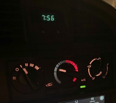

Is it possible to fix the ac control lighting?
It is possible to fix it but those micro bulbs that are used are almost impossible to find. The two buttons come out as drawers and inside there is a serviceable mini bulb. Sometimes if you have a junkyard nearby it is an option but they might be burned too. I tried the same with mine.
My GF used to have a Sentra B13 years ago and those two bulbs failed (recirculation and A/C) and we never found replacements.
I know this is not it, but for anyone interested in the digital climate control module, it has easily replaceable bulbs, they're called T5 which you can find pretty much everywhere:
