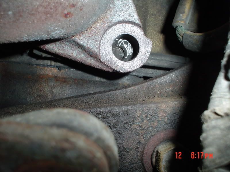

My 92 pathy has the same problem, has a ticking noise at idle, and gets louder/faster as i accelerate. Simon's description is dead on with my scenario. Broken stud at front of engine on passenger side. I thought it was coming from my power steering pump, but that was before i noticed the broken stud.
