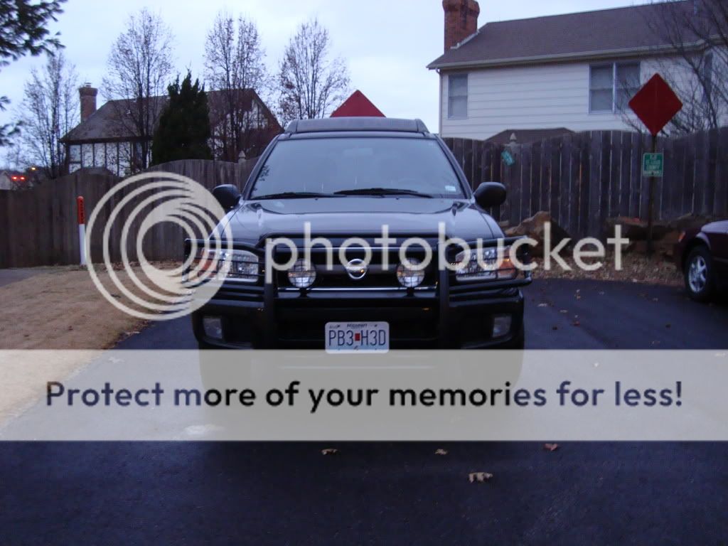

I decided I would make a light bar for the roof over this past spring break and thought I would post how I did it on the forum to help others.I decided to uses a 1x1 square steel and then painted it black. The First thing was to remove the wind deflector from the the roof rack. I then cut a rectangle out of the suport and attached the light bar using the bolt that held the deflector down. I then ran the wires under the weather stripping on the passenger side door into the engine bay and also to the switch located on the dash board, and also grounded the lights through the sun roof. Here are some pictures.

The weather finaly cleared up enough so that I could finish wiring these lights so I took some pictures and figured I would post them to help others.

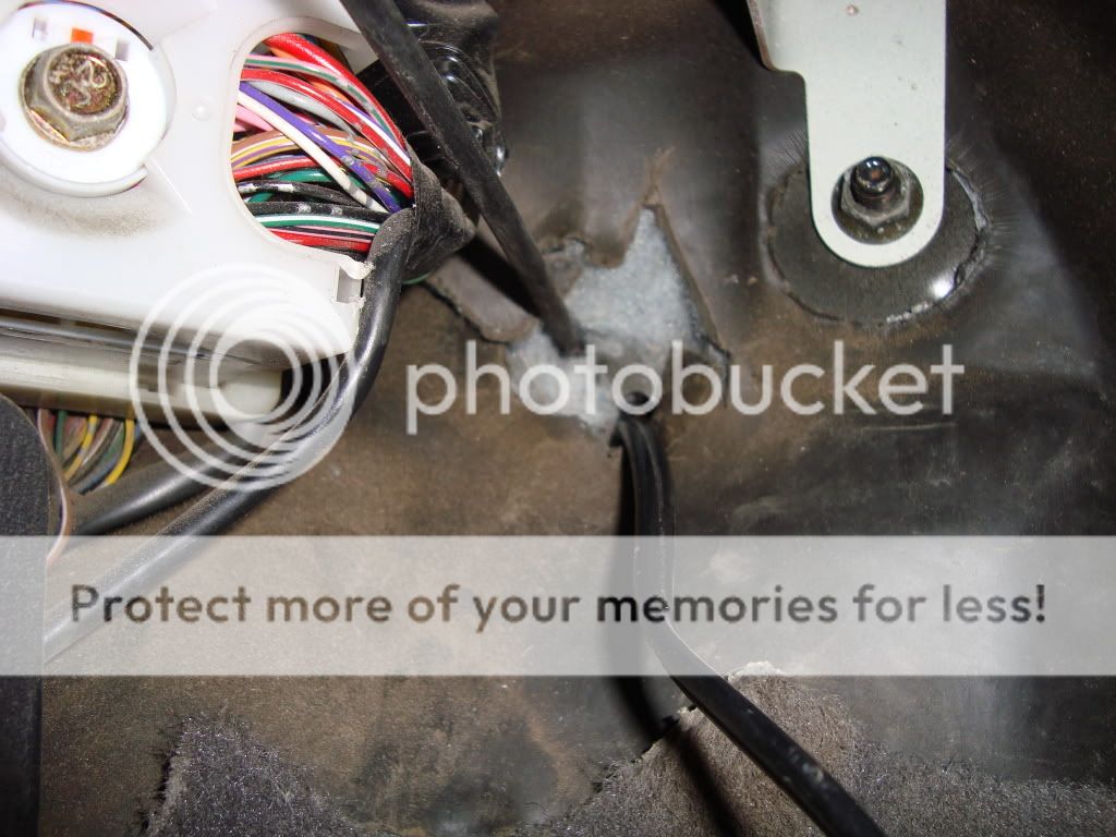

So I spent a while trying to figure out what the best way through would be and decided that I would go through the left wheel well right next to where the hood release cable went through.
This picture is from the inside looking at where the hood release cable exits the cab. ( the wire is already pushed through ) I just drilled about a 1/4" hole through the firewall.

Picture from the outside.
Wasn't that difficult once I decided where I was going to go through, the hardest part was getting the fender well covers off and on. Thanks for the help guys
So I am trying to run 3 wires through the firewall into the cab in order to hook up the auxiliary lights i just bought but I cannot find a good spot to go through. I've searched for the holes where the existing wires go though but I can only find one but it is jammed packed full of wires. Any suggestions? pictures would help a lot. Thanks
