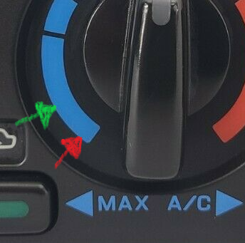

Oh, I just realized that there are actually 3 issues...but 2 of the 3 are part of the climate control bits anyhow lol. Anyways, so the mode switch is one issue on the climate controls, the other has to do with the blender (hot/cold) switch. So, when I have the fans running, I have to have it all the way over on cold (red arrow) just to have it blow room temp air. But if I go about 2 clicks over(it does have some kind of dimple thing inside and can feel it as you turn)(Green Arrow), it starts to blow full hellish heat. its odd how it does that as its still on the cold side of the controls.
