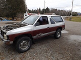

Damn gremlins !!! Pulled pump and works fine on the bench! Test the plug and got 12.3V ? Reinstall pump and it starts up like there was no problem . Pulled it out and let it run to temp. Ran it around My 11 acres tested the 4x4 and made sure it will shift through all the gears .It all seems fine? I should have the glass by fri . I still need a hood if anyone has one and I will charge up the AC tomorrow. It will be looking for a new home so I will list it here first.
Well this thing is just tons o fun! Clutch was a snap new master and all is good. Rad was a breeze after I got the rad cradle straitened out. On to the fuel system #!@%$#%&^ New pump new filter flushed tank and replaced all rubber lines. First I had a low voltage problem that I think was a ground and then I found I switched the polarity on the pump ! Fixed that and it ran like a champ! Reinstalled the breather ( has to be the worst design ever) and let it idle in shop foe half an hour. Stat opened and the cooling system seems good. I set it on all four sears tires and backed it out of the shop. Clutch seems great and it idled for another 20 min while I swept up. I jumped in the captains seat and threw it in gear and headed across My parking lot . First gear lots of snot (NO PROB) Second gear and it dies! No fuel pressure? Go back to the pump and Have only 8 volts? So I ask the Nissan masters. Where is My low voltage problem coming from? I have checked grounds and fuses . Relays seem to test good. This ride has been sitting for 16 years. Is this an easy fix Or do I take it out to the range and put a mannequin with a Trudeau mask in the drivers seat and shoot the day lights out of it for views on Youtube?
